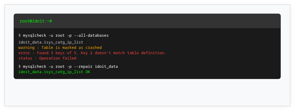

This article describes typical MariaDB errors after database corruption and shows a possible solution approach.
Error messages#
The following error messages frequently occur after a power outage, an aborted update, or an operating system update — they usually indicate database corruption:

Possible solution approach#
We assume no responsibility for these solution approaches and cannot guarantee that the errors will be fixed. Make sure you have created a backup or snapshot beforehand.
The cause often lies in damaged InnoDB log files (ib_logfile0 and ib_logfile1). These files are system tablespaces for the InnoDB infrastructure. More information can be found here.
