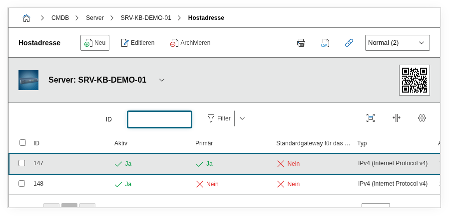

Category: Host Address#
The Host Address category is the central category for IP address management in i-doit. It is a multi-value category -- any number of IP addresses can be recorded per object, for example when a server is reachable via multiple network interfaces in different networks or when an interface carries both an IPv4 and an IPv6 address.
The Host Address links three levels together: the IP address itself, the Layer 3 net object in which it resides, and the physical or logical port through which it is reachable. This interplay makes the category the hub of network documentation and is simultaneously the most common source of configuration errors.
Most common error: No net assigned
An IP address must be assigned to a Layer 3 net object. If this assignment is missing, the address ends up in the predefined catch-all net "Global v4" or "Global v6" and does not appear in the IPAM overview of the desired subnet. The consequence: the address appears as "not assigned", IP lists remain incomplete, and duplicate assignments are not detected. After creating a host address, always verify that the correct Layer 3 net object is selected in the Net field.
  • IP Address Management (IPAM): i-doit manages occupied and free addresses within Layer 3 nets. Each host address entry automatically occupies an address in the assigned net object. Through the net category, you can see at a glance which addresses are free, assigned, or reserved.
  • DNS documentation: Hostname, domain, and DNS server are maintained directly on the object. i-doit constructs the FQDN (Fully Qualified Domain Name) from these, e.g. srv-db-01.bhb-ag.local, and displays it as a calculated field. The FQDN appears in reports and exports -- a consistently maintained hostname and a correct domain are therefore prerequisites for meaningful evaluations. DNS aliases (CNAMEs) can be added via the Aliases field.
  • Network assignment: Through the link to a Layer 3 net and a port, a continuous documentation chain from the cable through the switch port to the IP address is created. The connection to the Port category links the logical IP address with the physical network interface -- so in the event of a network problem, you can immediately trace which switch port the affected device is connected to. Reports can query this chain, e.g. "Which servers are in VLAN 100?".
  • Primary IP in lists and monitoring: The Primary IP address flag determines which address is used in the object list, in reports, and for monitoring exports (e.g. Nagios, Checkmk). Exactly one address per object should be marked as primary. If the flag is missing or two entries are accidentally marked as primary, unexpected behavior occurs in exports and reachability checks.
  • Combination with Access and Contact Assignment: The Host Address provides the IP, the Access category the specific service URL, and the Contact Assignment the responsible person. Together, they create a complete picture: which address, how reachable, who is responsible.

Interplay of IP, Net, and Port#
The three fields IPv4/IPv6 Address, Net, and Assigned Port together form the backbone of network documentation. Only when all three are correctly set do reports and the network plan visualization deliver complete results.
Recommended sequence when creating:
  1. Create Layer 3 net object (e.g. "Server Network 192.168.10.0/24" of object type Layer 3 Net), including subnet mask and gateway.
  2. Create port in the Port category of the target object (e.g. "eth0").
  3. Create host address: select net, enter IP address (or accept the suggested free address), assign port.
Common errors:
  • No net assigned: The IP ends up in the "Global v4" net and does not appear in the IPAM overview of the desired subnet.
  • No port assigned: The IP is documented but not linked to the physical interface -- the connection is missing in network diagrams.
  • Multiple primary IPs: If two entries are accidentally marked as primary, unexpected behavior can occur in monitoring exports.
