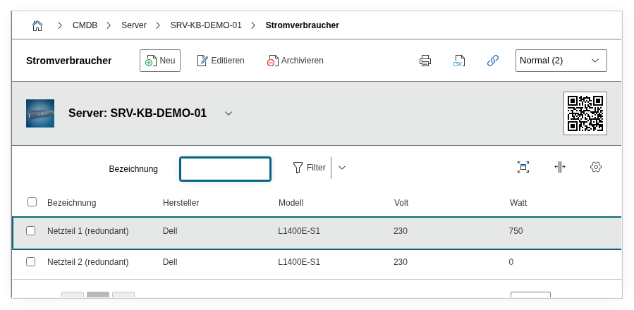

Create Entry#
21
        "category": "C__CATG__POWER_CONSUMER",
            "title": "Netzteil 1 (redundant)",
            "active": 1,
            "manufacturer": "Dell",
            "model": "L1400E-S1",
            "volt": 230,
            "watt": 1400,
            "ampere": 6.1,
            "btu": "4777",
            "description": "PSU A, Feed Left, 80 PLUS Platinum, Redundanz-Partner: Netzteil 2"
