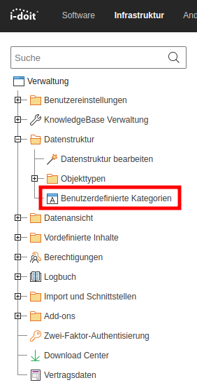

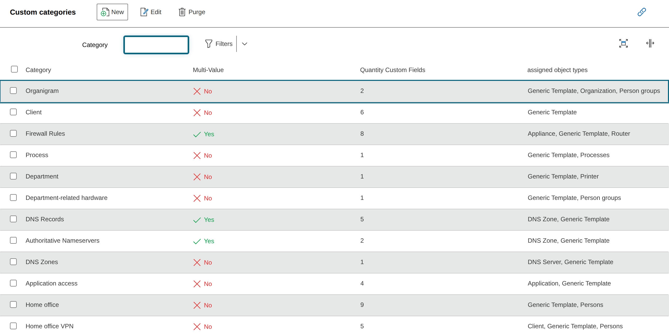

You can find the configuration under Administration → Data structure → Custom categories. Use the New button to create a new category. Existing custom categories can be edited there at any time.
custom-categories

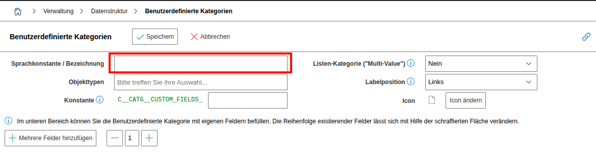

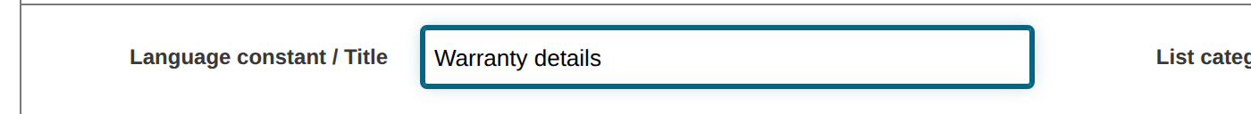

1. Assign a unique name
Give the category a unique name so you can easily identify it in the category list.

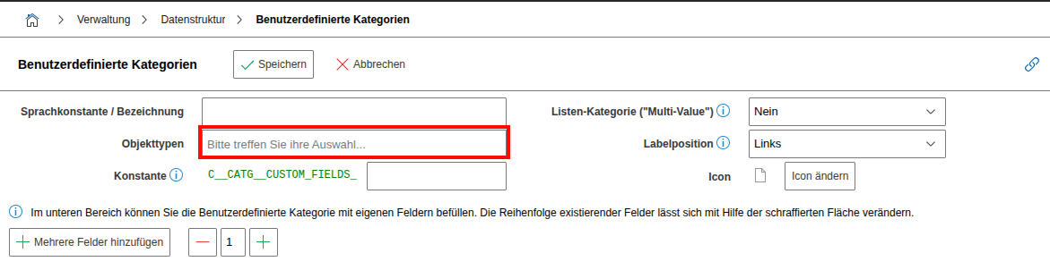

2. Assign object types
Link the category with one or more object types so it becomes available there.

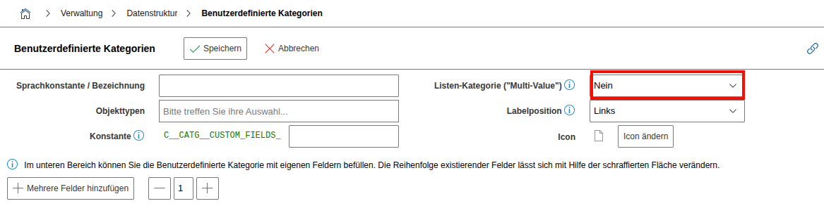

3. Set the category type
Choose between single-value and multi-value category (list category). If the attributes only need to be maintained once per object, a single-value category is sufficient. If you need multiple entries per object (e.g. multiple contracts), choose a multi-value category.

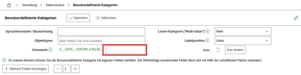

4. Define a constant
Define a constant so the category can be referenced in queries (e.g. in custom reports). i-doit automatically suggests a constant when creating -- you can adjust it if needed.

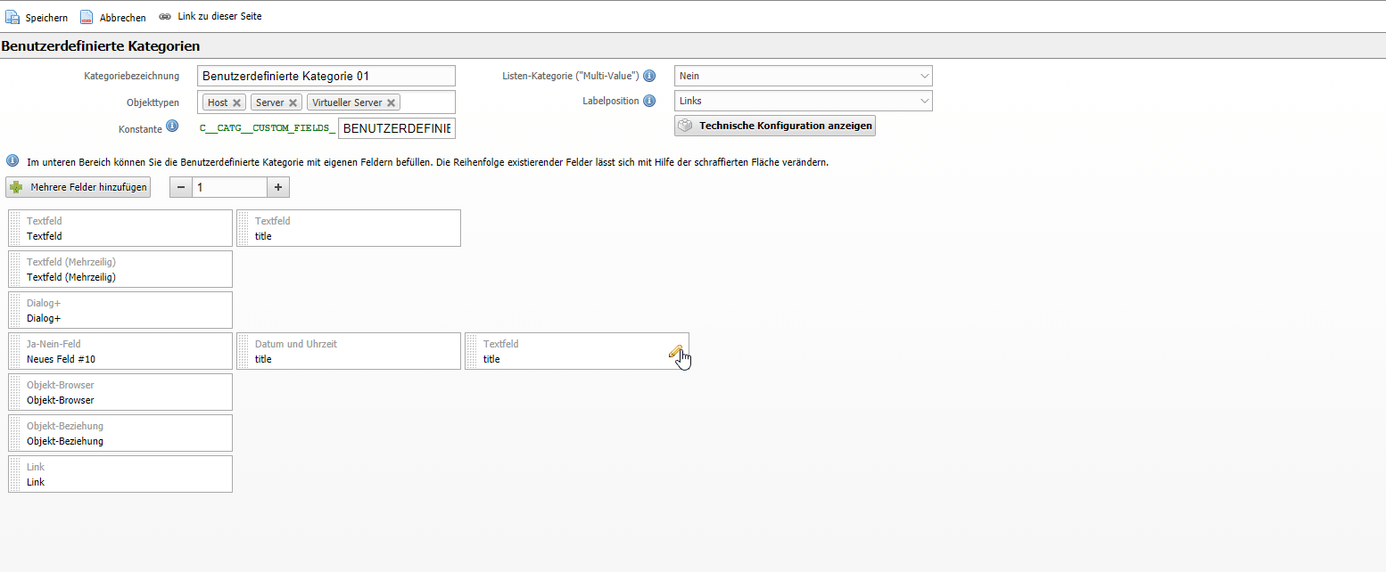

Defining the category#
To define your category with attributes, add any number of fields via the Add multiple fields button. The following field types are available:

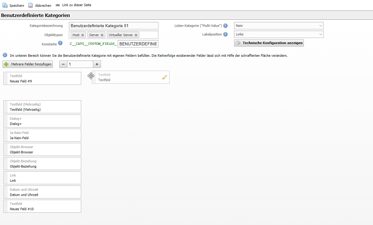

The order of created attributes can be changed via the hatched areas at the beginning of each row using drag-and-drop.

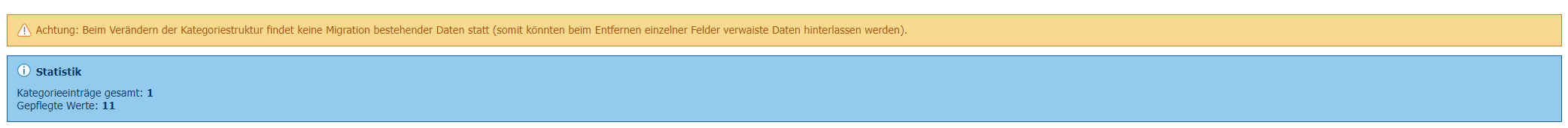

Once the category is in use, you can no longer change existing field types -- to avoid data loss. If you remove fields from the configuration, you lose access to their contents. After that, you must re-index the attributes via the System repair and cleanup.

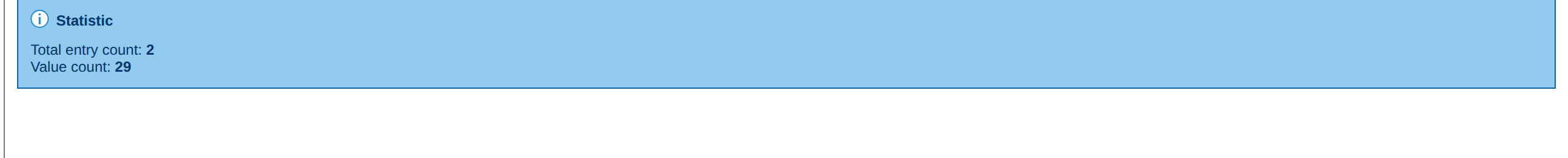

Below the configuration, an evaluation is displayed:
Statistic Description
Total category entries How often was the category saved? Per object, the entries (for single-value once, for multi-value per entry) are counted together.
Maintained values Each attribute that was filled in and saved is counted across all objects.
custom-categories-8

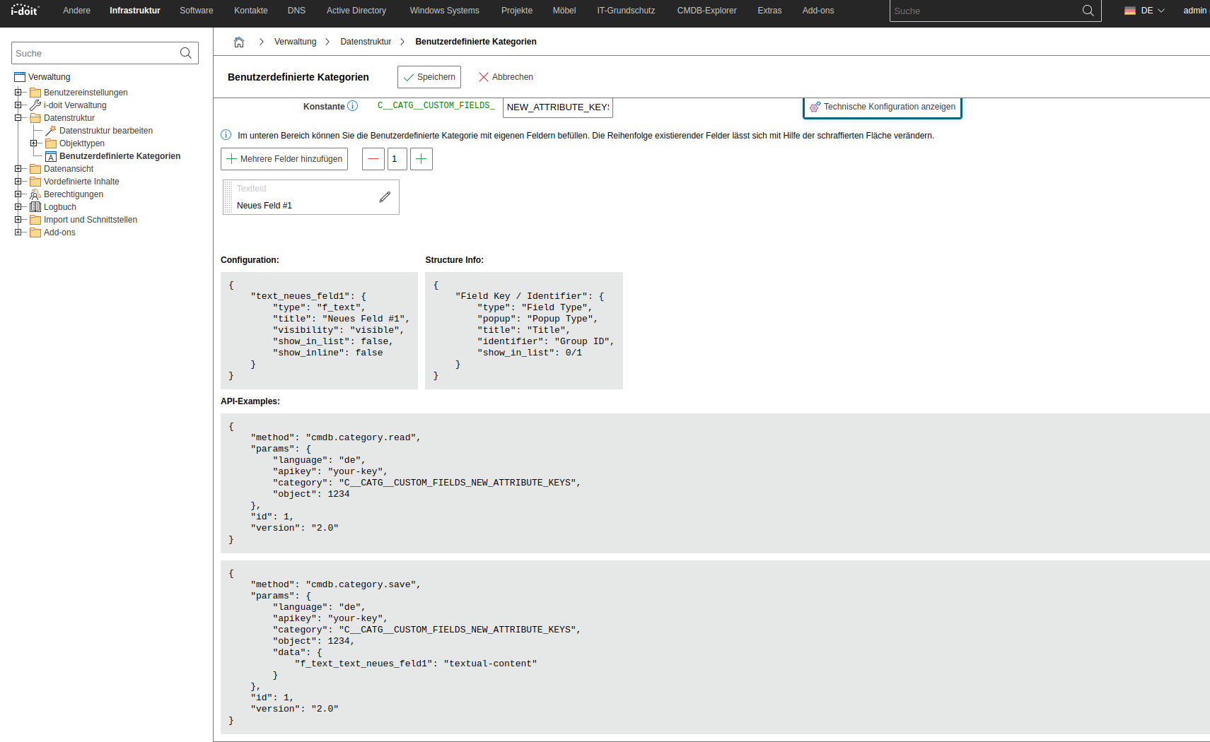

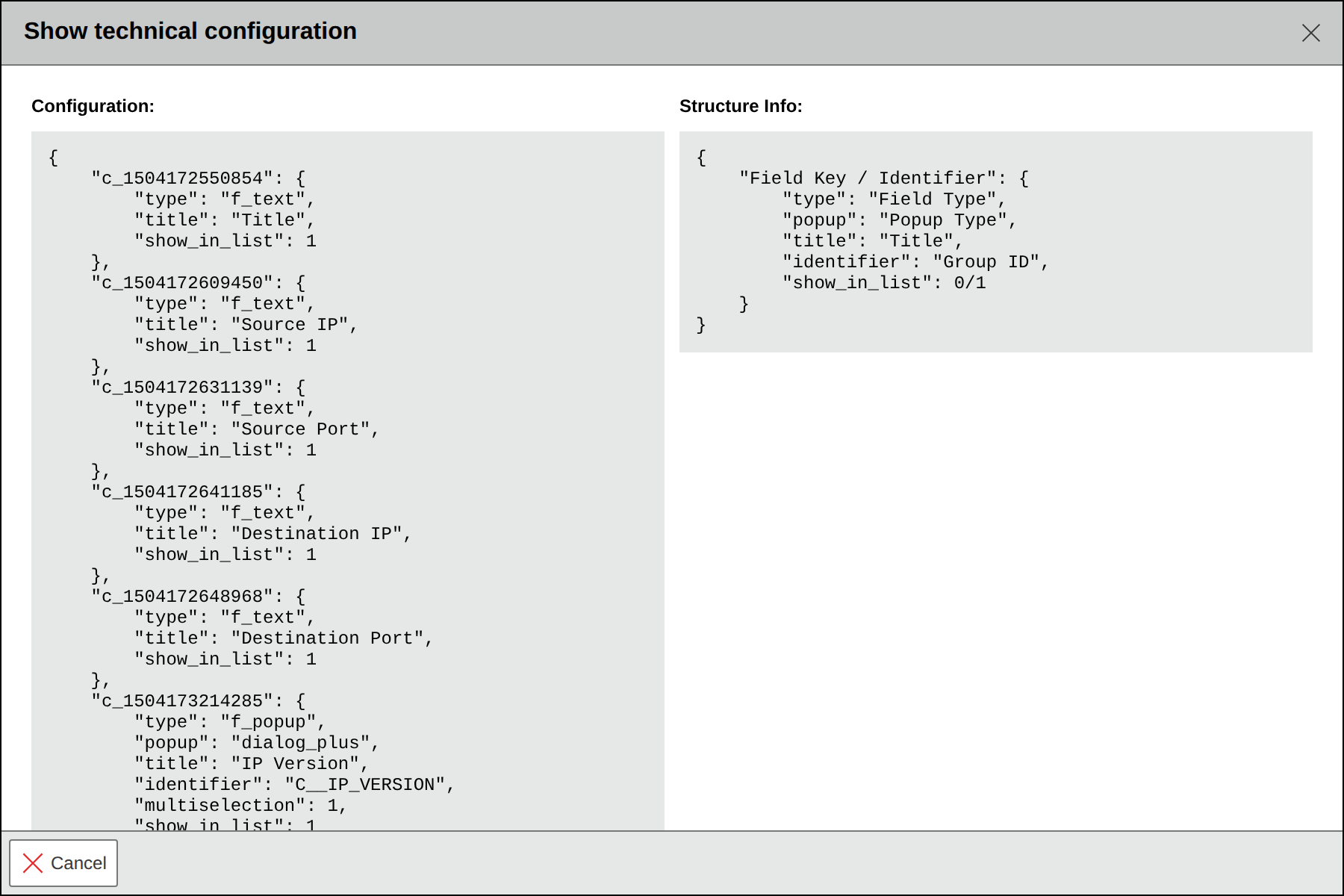

Technical configuration#

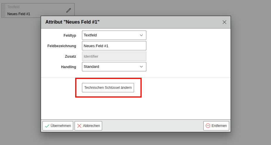

If you want to use the custom category via the API, you need the technical configuration. You access it via the Show technical configuration button.

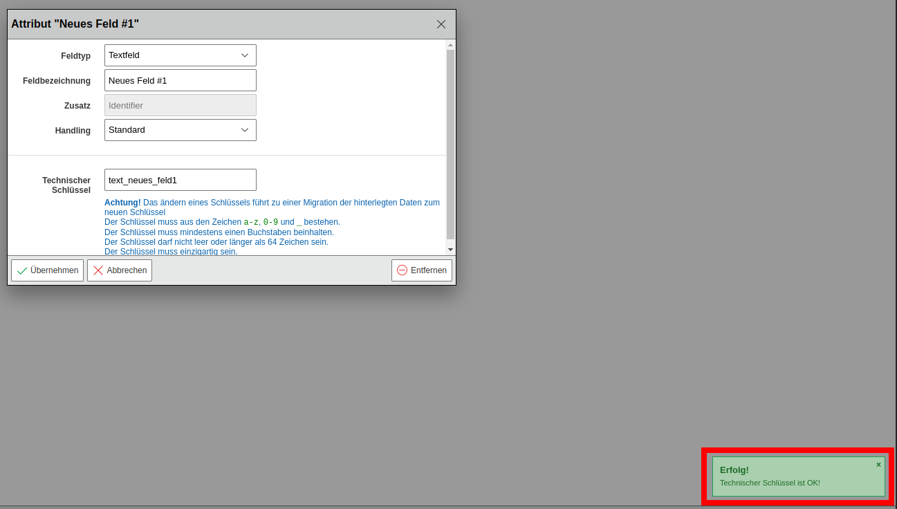

There you can change the technical keys for each field by clicking Change technical key.
Change-technical-key
Now you can change the key. i-doit automatically validates the new value before you can save.
Caution!
Changing a key triggers a migration of the stored data to the new key. Please observe the following rules:
- The key may only contain the characters a-z, 0-9 and _.
- It must contain at least one letter.
- It must not be empty and must not be longer than 64 characters.
- It must be unique.
After saving the custom category, you can view and use the new technical configuration.
Technical-configuration
