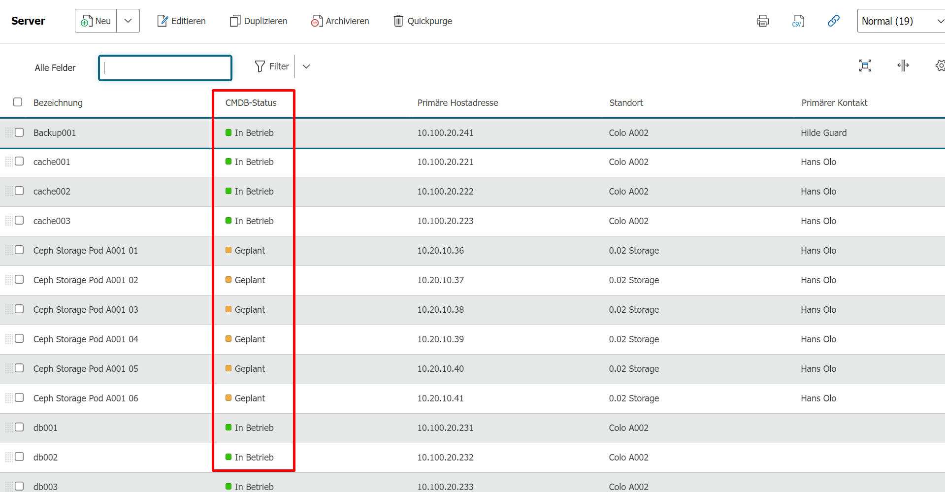

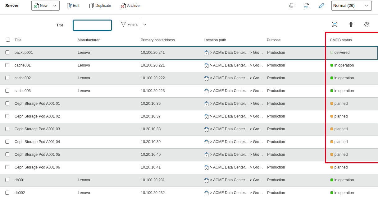

The CMDB status can be displayed as a column in the object lists in order to see the target condition of a documented object as fast as possible.

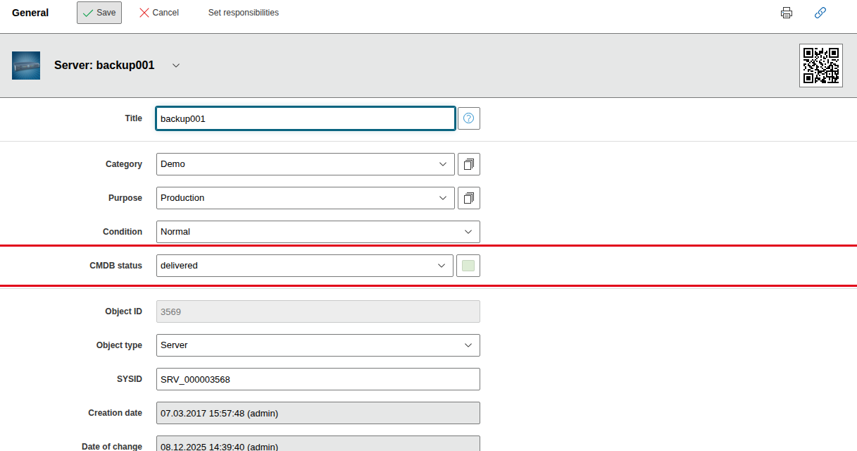

Set CMDB Status Per Object#

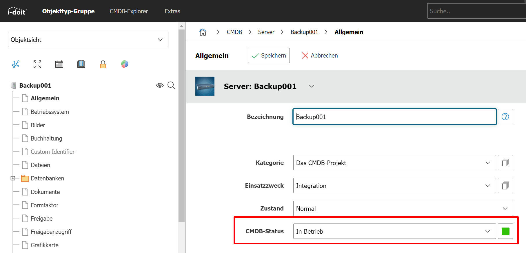

To represent the complete lifecycle of an object, the CMDB status attribute in the General category is used per object. If a new object is created, it receives in operation as its CMDB status, if not explicitly set to a different state.

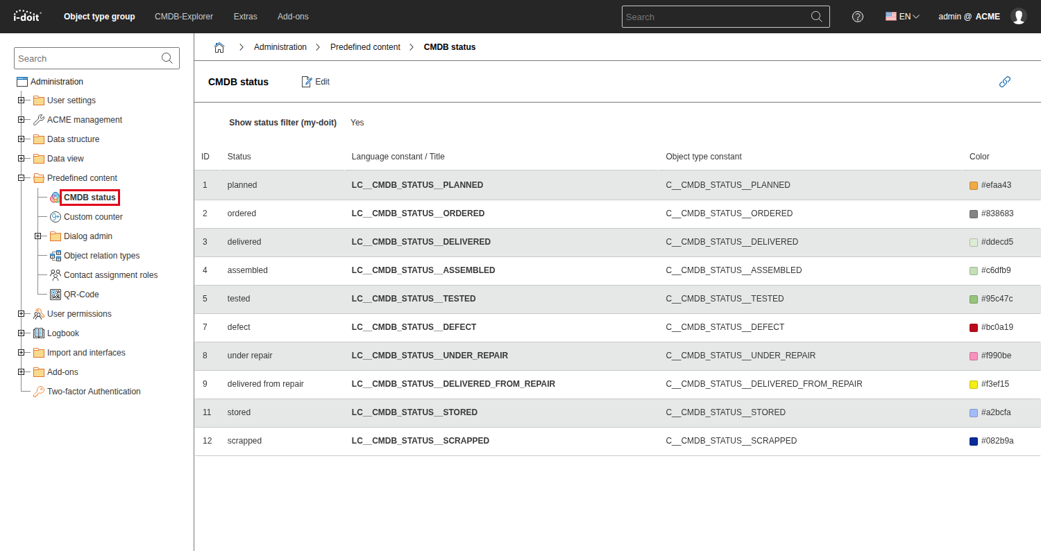

Manage CMDB Status#

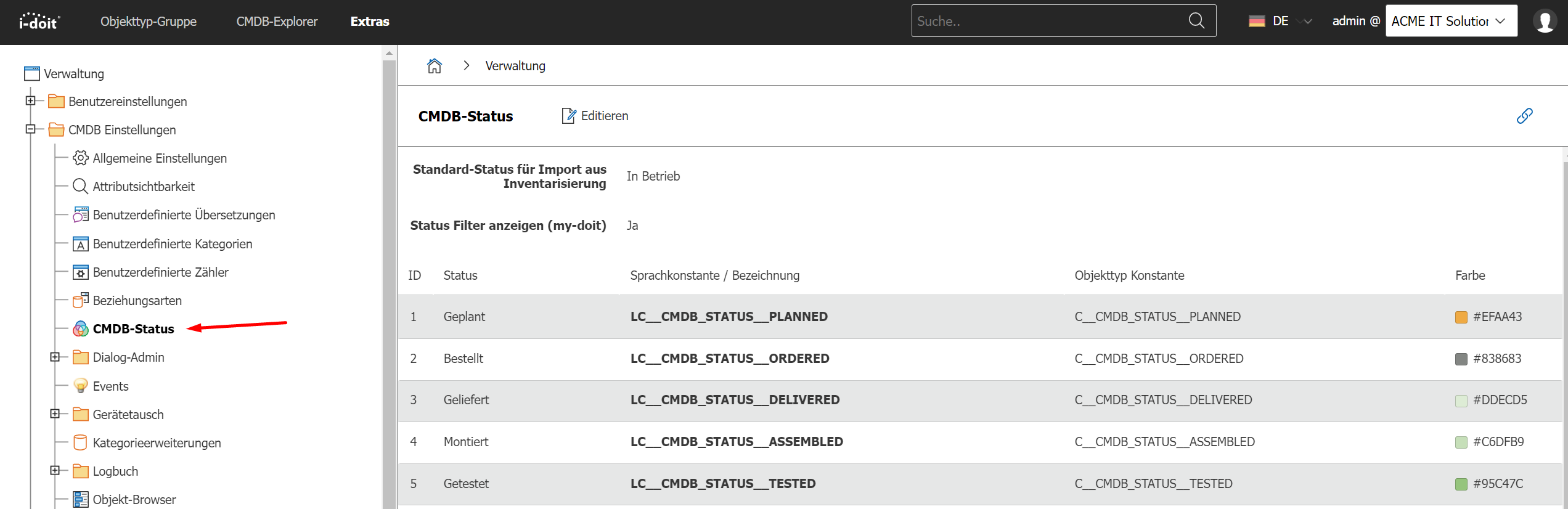

The adding, changing or deleting of a CMDB status is carried out via Administration → Predefined content → CMDB status. For each CMDB status the following information is needed:
- Unique name/ language constant (for translation)
 - Unique constant (helpful for using the API, for example)
 - Color (is used in object lists, the General category, in the CMDB-Explorer and many other cases)

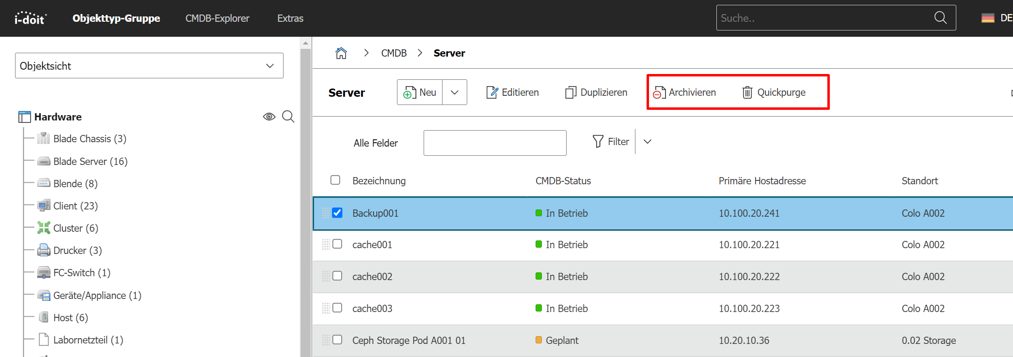

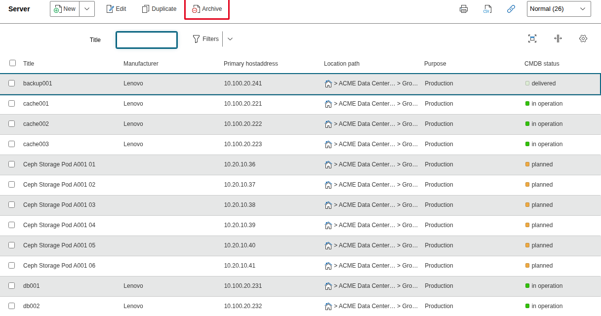

The state of an object is visible in the General category. If you wish to archive an object, mark it as deleted or purge it, you can do so via the object lists. For this purpose, the checkboxes of the corresponding objects are marked and one of the buttons Archive, Delete or Purge needs to be pressed.
It is only possible to change to the next possible state. If an object is in the Normal state, it will only be possible to change it to the Archived state. You can only delete an object by using the filtered list of archived objects in the right-hand corner. Using Recycle changes the object to its previous state.
There is no further query when purging an object except if relations to other objects exist.

In order to purge a documentation artifact it first has to be archived and marked as deleted. To shorten this cycle, it is possible to activate the Quickpurge button. This is done via Administration → [Tenant Name] management → Settings for CMDB → CMDB → Activate Quickpurge button. By this means you can purge an object or category entry regardless of its state.
