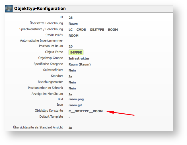

Each row additionally contains the object type constant. You can find it in the object type configuration:
Object type configuration

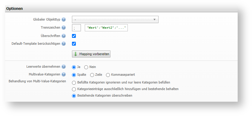

  1. Navigate to the CSV import under Extras > Import > CSV Import
  2. Upload the CSV file and click Prepare for Import
  3. Leave the settings in the upper area at the default values
CSV Import options

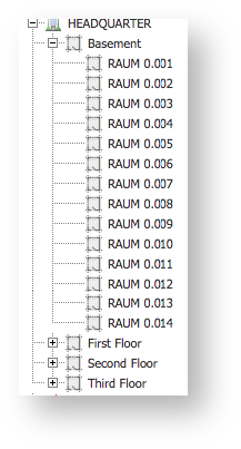

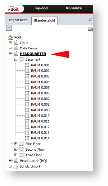

Result#
In the location view, you can now see the complete hierarchy:
Location view

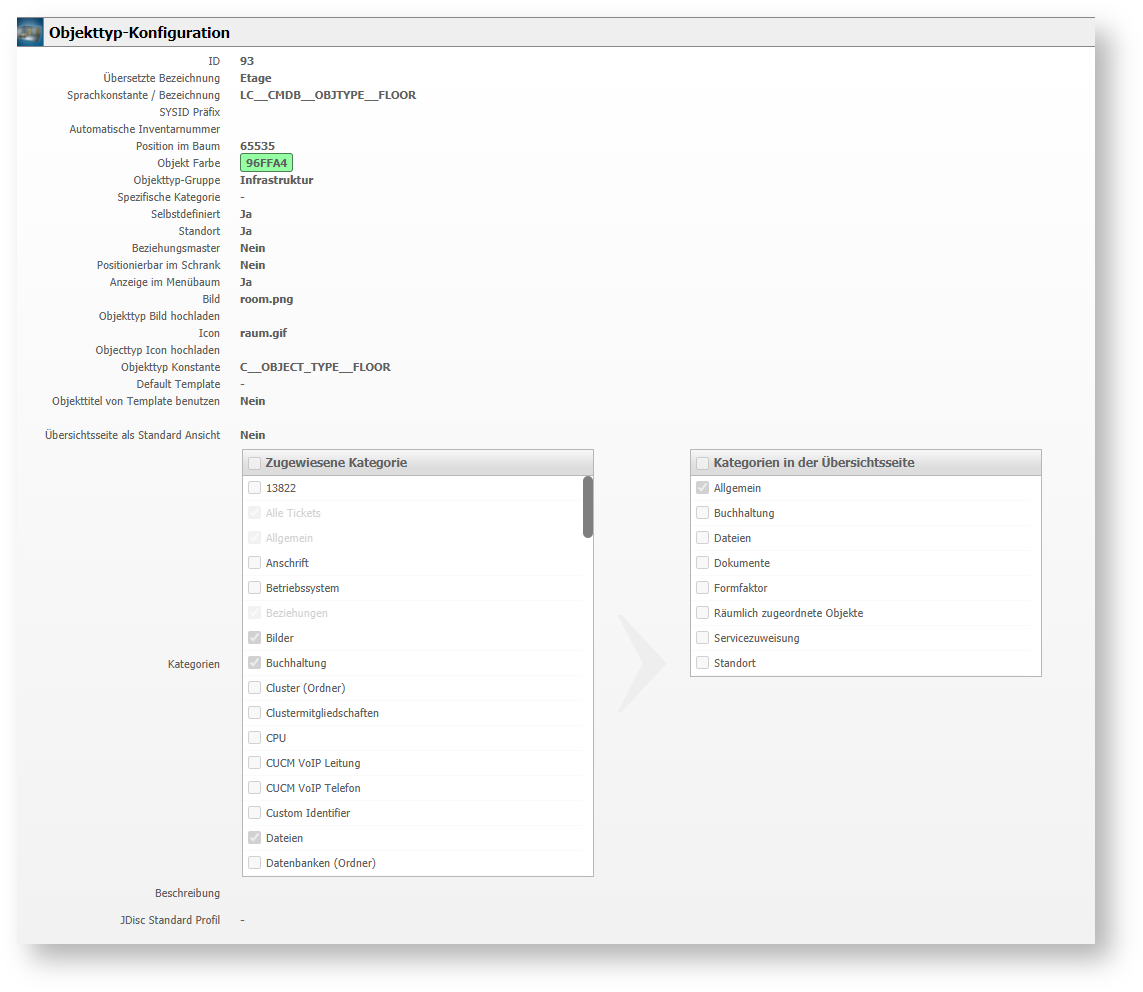

This is what the configuration of the custom-created object type Floor looks like:
