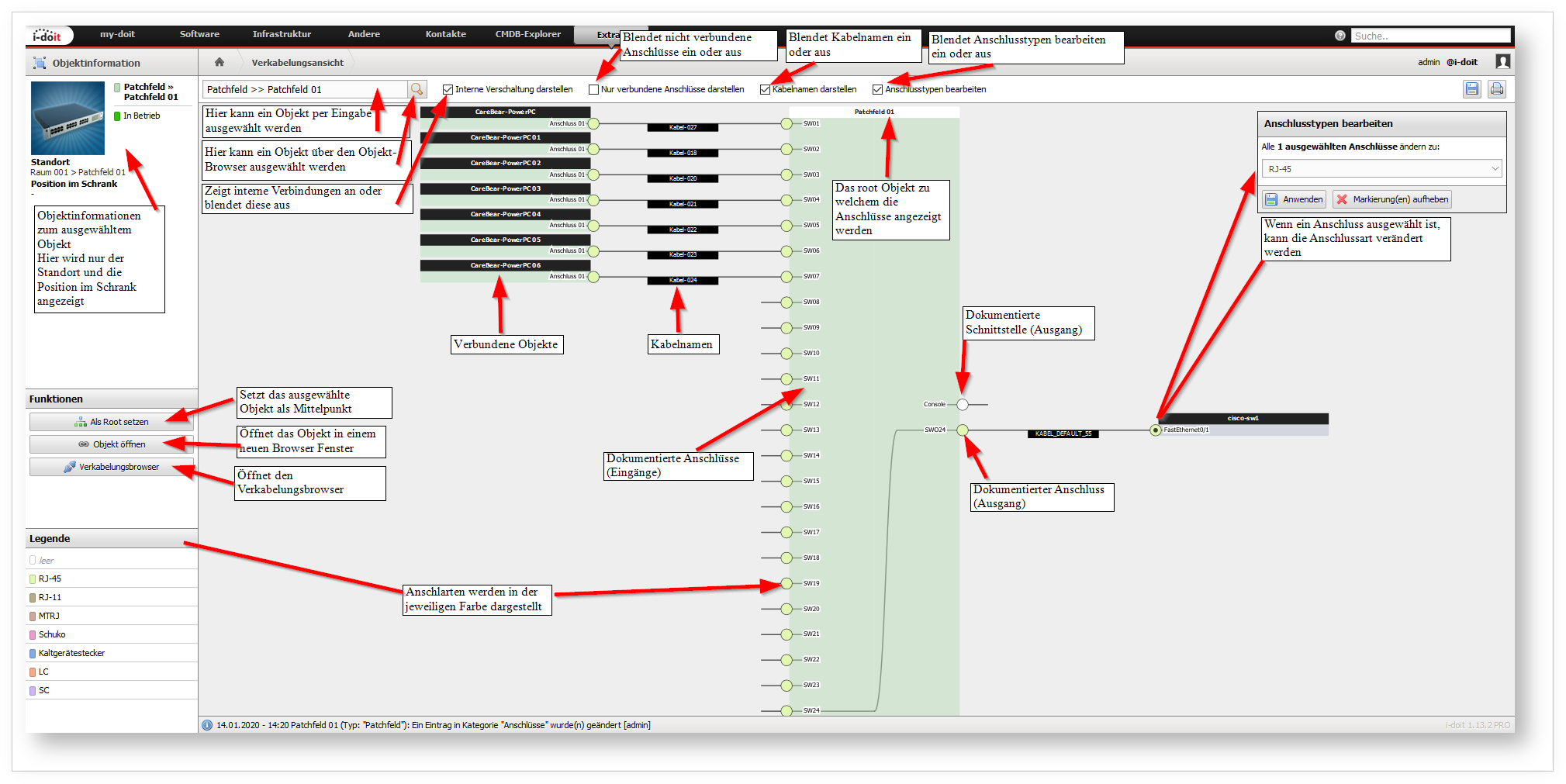

Cabling#
With the add-on Cabling view, you get a detailed display of cabling -- whether you want to trace a cable path or print patch orders.

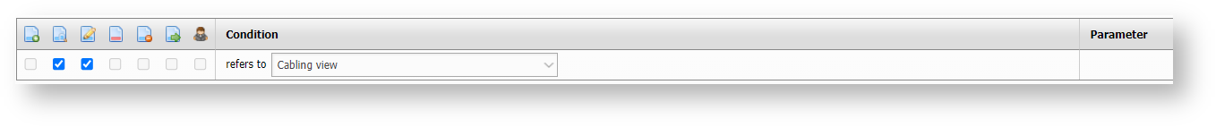

Configuration#
After installation, no further technical configuration is required. If you want to always open the cabling view directly, activate this under Administration → User settings → User interface. Alternatively, you can access the cabling view via the "Cabling" category in an object.

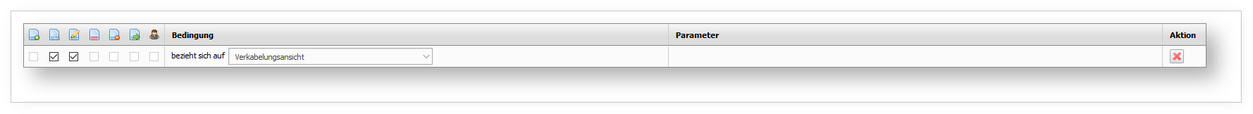

Assigning rights#
Under Administration → Permissions → Cabling view, permissions for persons and person groups can be adjusted.
After installation and configuration of permissions, the add-on is available under Add-ons → Cabling view.
