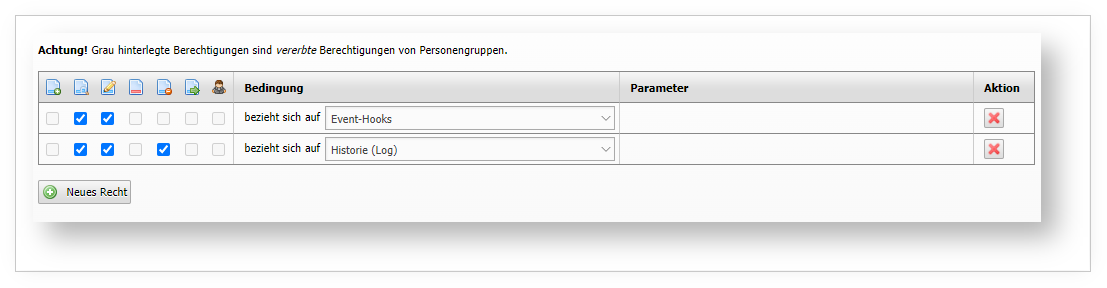

Rights assignment#
Under Administration → User permissions → Events, rights for persons and groups of persons can be adjusted.

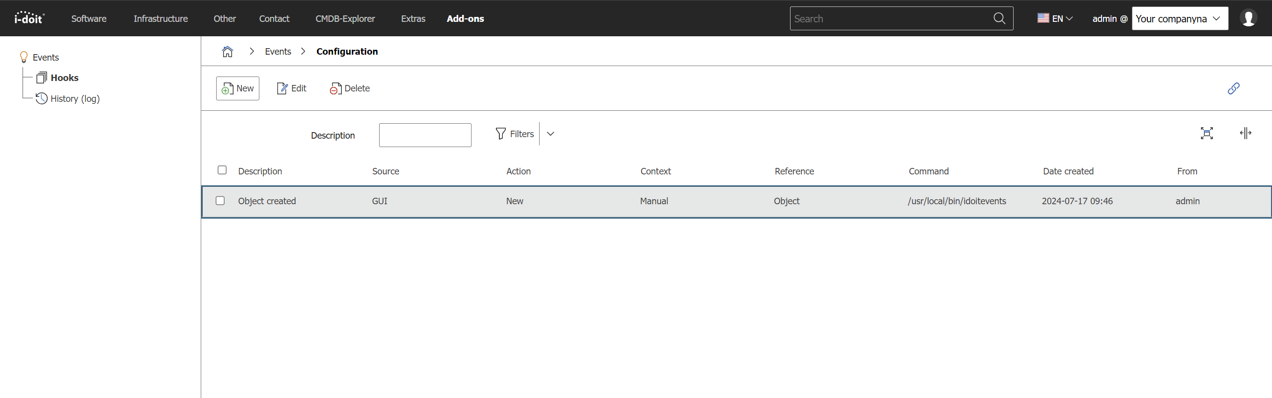

Configuration#
The configuration is accessed via Administration → Add-ons → Events → Hooks.
Configuration

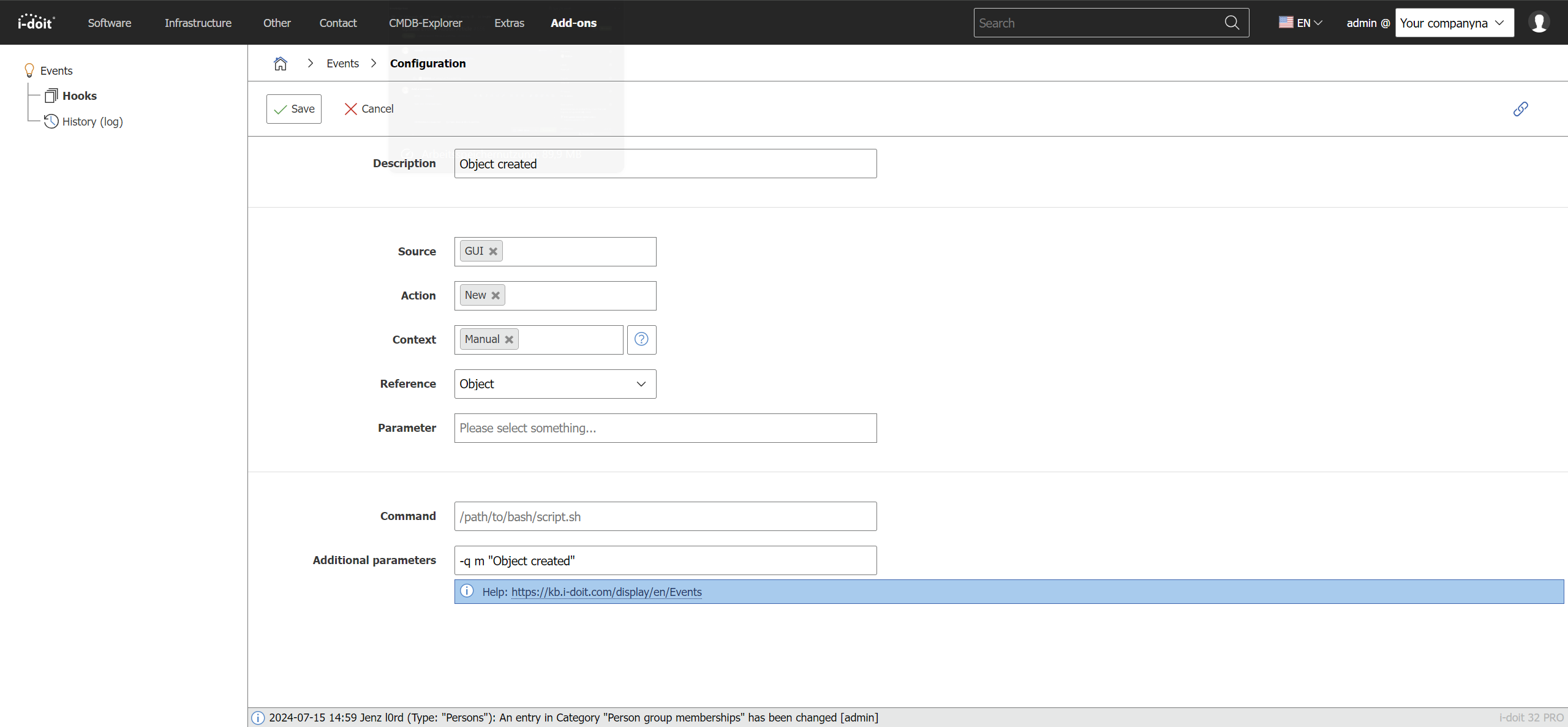

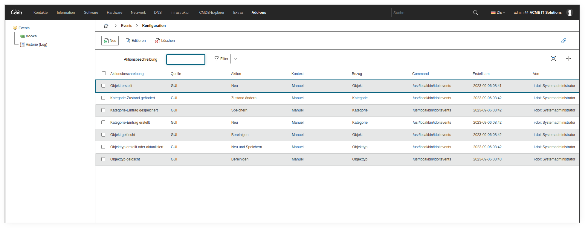

Events are combined with commands. An event is triggered by a hook, an internal routine in i-doit. The following events are available:
Thus there exist matching events for all states in the IT documentation. As many event-to-command combinations as desired are possible.

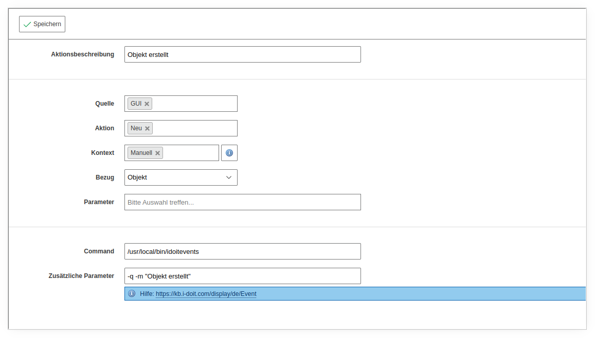

The command is carried out immediately once the configured event occurs. A shell script is executed for this purpose. This requires the rights to be executed by the user or group with whose rights the web server is running. On a Debian-based operating system this is the user www-data with the group of the same name. Because of this, the script under GNU/Linux requires the right bit for executing (x). The programming language is arbitrary but it should be supported by the operating system (Bash, PHP, Python, Perl etc.).
command
Information about the event is referred to the shell script. The information is encoded as JSON with BASE64. The following is an example of a JSON string when saving a category entry (the BASE64 decoding already took place):

Additional parameters that are given to the shell script can also be set. These are static, in other words without a placeholder.

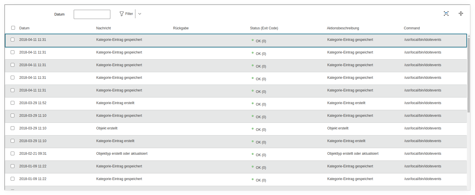

Logging#
When an event is triggered and it is linked to a command, then this execution is logged. The last 500 entries are listed at Administration → Add-ons → Events → History (Log).
