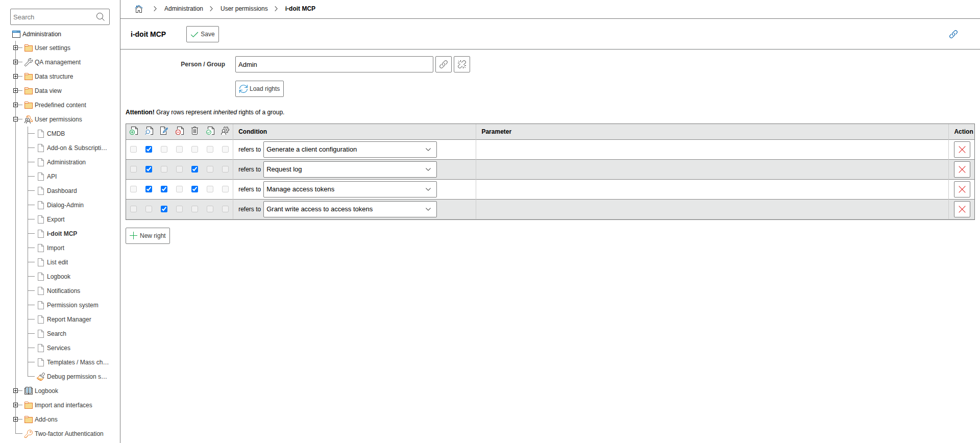

Assigning rights#
Under Administration → User permissions → i-doit MCP, permissions for persons and person groups can be adjusted:
Right Purpose
Generate a client configuration Open the How to connect page and generate a client configuration
Request log View the request log (View) and clear it (Delete)
Manage access tokens View, create, enable and disable access tokens (View, Edit) and delete them (Delete)
Grant write access to access tokens Mark access tokens for writing or make them read-only again
Rights for i-doit MCP
Holding an access token is what admits a client to the MCP server. There is no separate permission for it. To withdraw access, disable or delete the token.

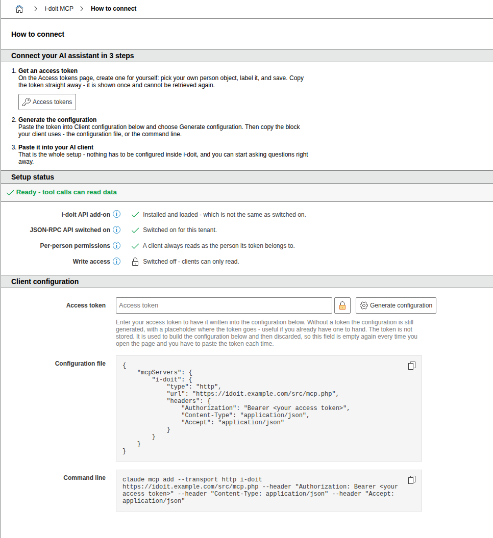

Open Add-ons → i-doit MCP → How to connect. The page shows the section Connect your AI assistant in 3 steps, a Setup status and the Client configuration.
How to connect
The Setup status shows four items:
  • i-doit API add-on: whether the API add-on is installed and loaded. Without it, category data cannot be read.
  • JSON-RPC API switched on: whether the JSON-RPC API is switched on for the tenant. While it is off, every tool call is refused.
  • Per-person permissions: a client always reads as the person its token belongs to. Nothing has to be configured for this.
  • Write access: whether AI clients may change data, see Write access. This is not a prerequisite, reading works either way.
Only when the first two items are met can tool calls read data.

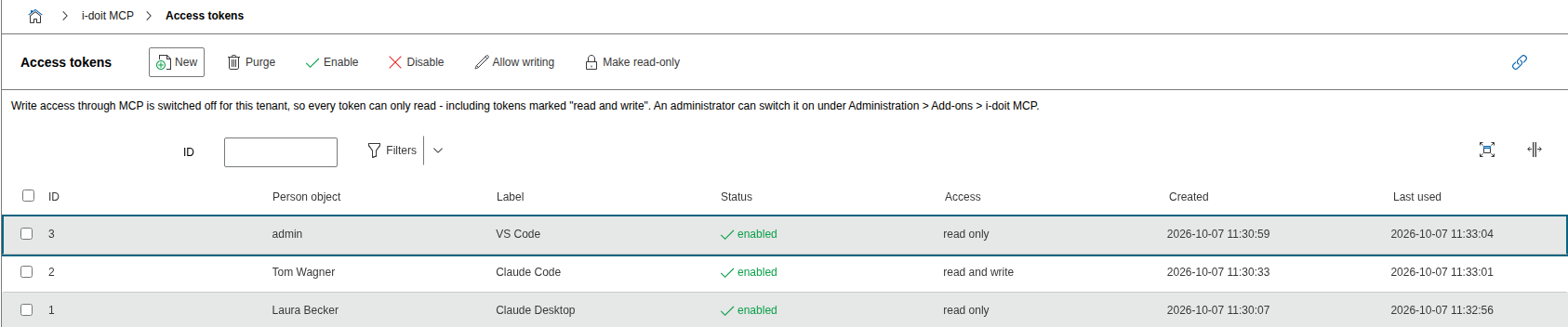

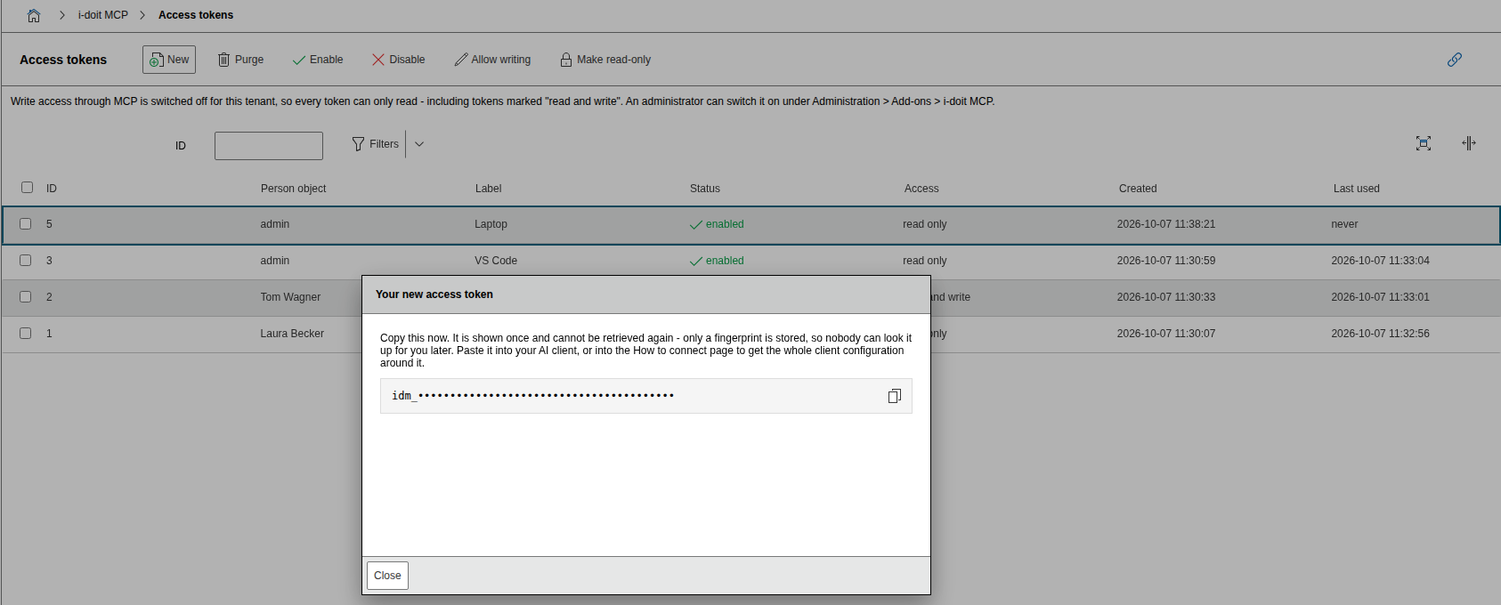

1. Get an access token#
Create a token on the Access tokens page with New:
  1. Select the Person object the token belongs to. Only person objects can be selected.
  2. Optionally enter a Label, for example the device or client the token is used on.
  3. Save.
The new token is shown only once. Copy it right away. i-doit only stores a fingerprint, so the token cannot be displayed again later. If you lose it, delete the token and create a new one.
New access token
A token always belongs to the tenant in which it was created and only works there. The person of a token cannot be changed afterwards. Create a new token for another person instead.
2. Generate the configuration#
Paste the token into the Client configuration section and click Generate configuration. You receive two blocks to copy:
  • a configuration file for clients that are configured via a file
  • a command line for clients that are configured on the command line
Both blocks already contain the address of your i-doit installation and your token. The token field is optional. If you leave it empty, the blocks contain a placeholder instead of the token.
The page does not store the token. The field is empty every time you open the page.
The configuration file has this shape:
  "mcpServers": {
    "i-doit": {
      "type": "http",
      "url": "https://idoit.example.com/src/mcp.php",
      "headers": {
        "Authorization": "Bearer <your-token>",
        "Content-Type": "application/json",
        "Accept": "application/json"
The command line, here for Claude Code:
claude mcp add --transport http i-doit https://idoit.example.com/src/mcp.php \
  --header "Authorization: Bearer <your-token>" \
  --header "Content-Type: application/json" \
  --header "Accept: application/json"
Use the generated address
Always copy the address from the generated configuration. i-doit derives it from the address under which you reach the installation.
3. Paste it into your AI client#
Paste the configuration into your AI client. The client discovers the available functions by itself. There is no prompt field in i-doit: you ask your questions in your AI client.

The Access tokens page lists all tokens of the tenant. Select one or more tokens and use the buttons in the toolbar:
  • Enable and Disable switch a token on or off. A client with a disabled token stops working immediately.
  • Purge removes a token for good. This cannot be undone.
  • Allow writing and Make read-only set whether a token may change data. The column Access shows read only or read and write.
New tokens are always read only.

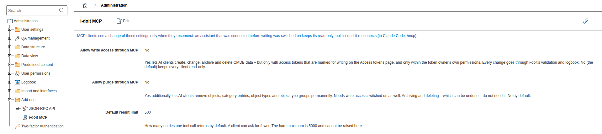

Write access#
Reading works without any further setting. Writing needs all of the following at the same time:
  1. The i-doit permission system is active: Permission system in the section Security of the tenant settings. It is active by default.
  2. Allow write access through MCP is switched on under Administration → Add-ons → i-doit MCP. It is off by default.
  3. The token is marked for writing (read and write).
In addition, every single change is checked against the CMDB permissions of the person the token belongs to, and it runs through the validation and the logbook of i-doit.
Purging data additionally needs Allow purge through MCP. This setting only takes effect while Allow write access through MCP is switched on as well.
Passwords are never returned to the AI client and cannot be written through MCP.
Settings#
The settings are located under Administration → Add-ons → i-doit MCP. Viewing and changing them requires the right for the system settings.
i-doit MCP settings
Setting Meaning
Default result limit How many entries one tool call returns by default. Default value: 500. A client can ask for fewer. The maximum is 5000.
Allow write access through MCP Allows tokens marked for writing to change data, see Write access
Allow purge through MCP Additionally allows purging
Reconnect the client
MCP clients only see a change of these settings after they have reconnected.

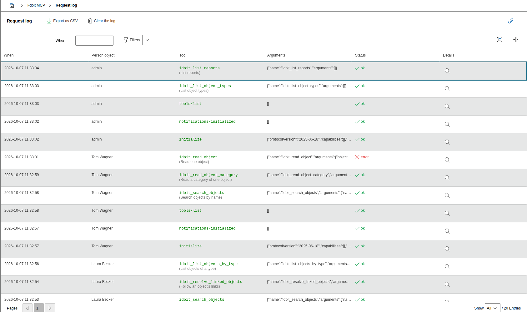

Request log#
The Request log page lists every request of the AI clients with time, person, method and tool. Show details opens the arguments and, if any, the error of a request.
  • Export as CSV downloads the complete log. The filter on the page does not apply to the export.
  • Clear the log deletes all entries. This cannot be undone.
