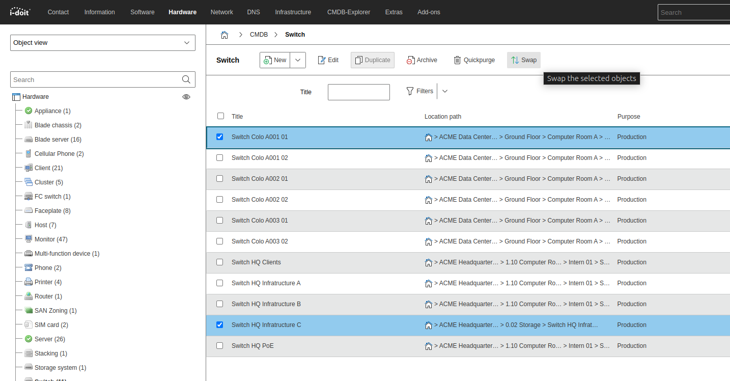

| Swap CI-button in object list | The user can swap objects via the action bar of the object list. For this purpose, the Swap button will appear in the action bar. |

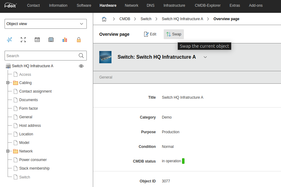

| Swap CI-button in objects | Via the action bar within an object, the user can swap the object with another one. For this purpose, the Swap button will appear in the action bar. |

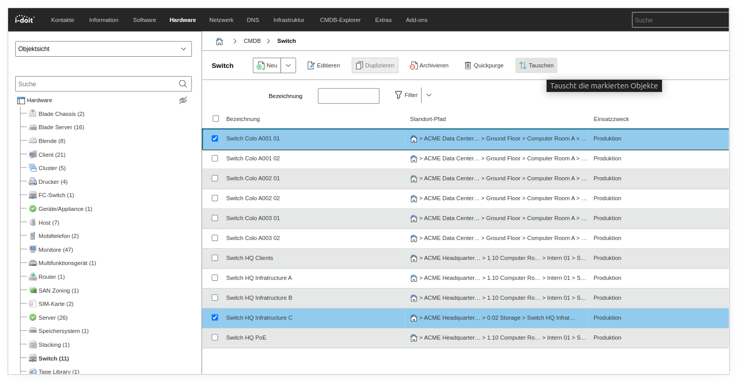

- Select both objects within an object list and click the Swap button in the action bar.

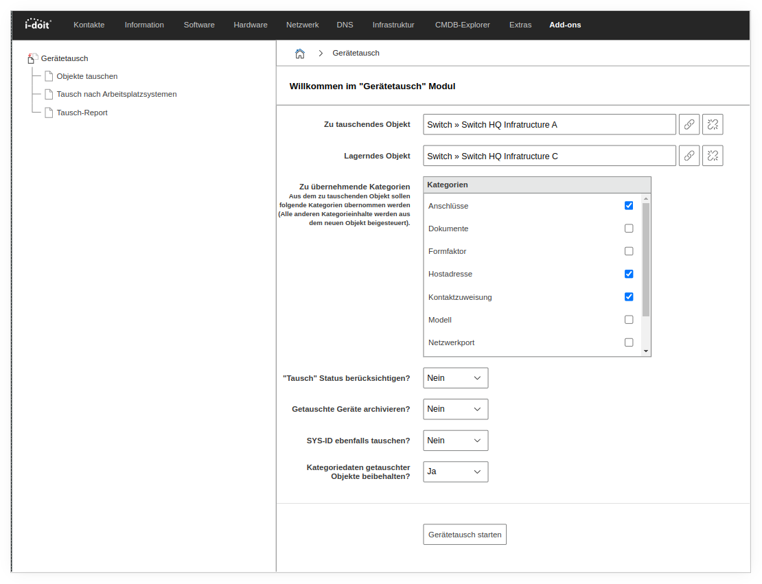

- Click the Swap button in the action bar within an object and then select the object of swapping under Stored object.

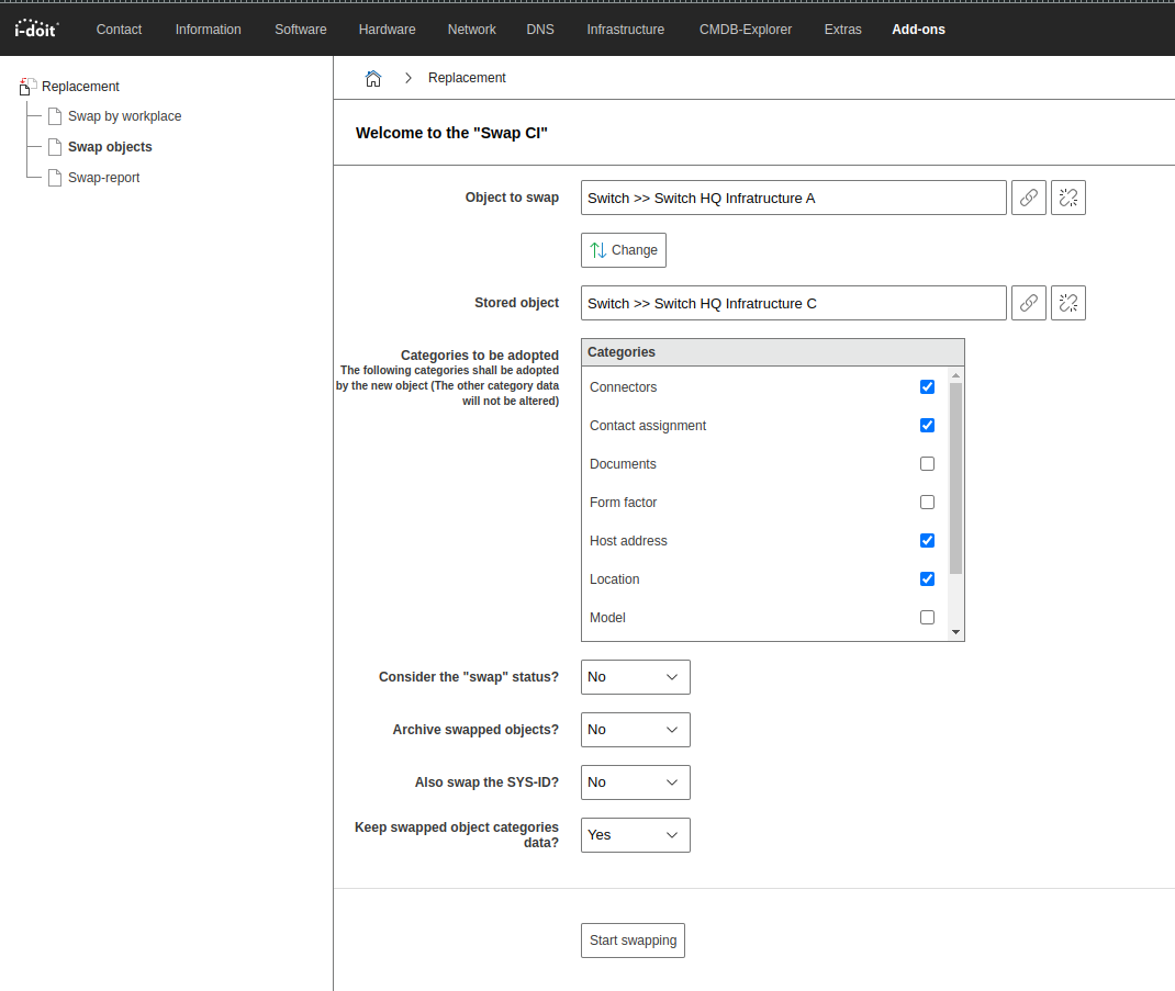

- Select both objects under Object to swap and Stored object at Add-ons → Replacement.
Only possible if the #Configuration has been carried out beforehand and the object type has been selected.
Now you can swap the selected objects by clicking the Change button.
After selecting both objects, you can adjust further options. The pre-selection is from the above mentioned configuration. By clicking the Start swapping button both objects will be swapped.

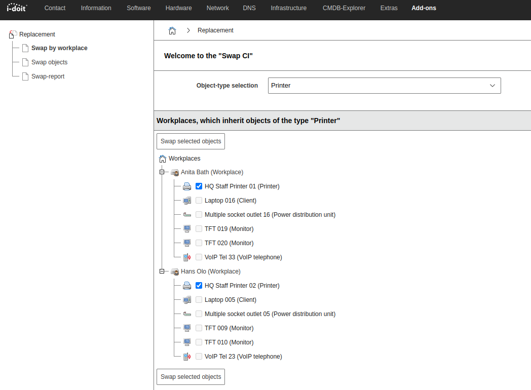

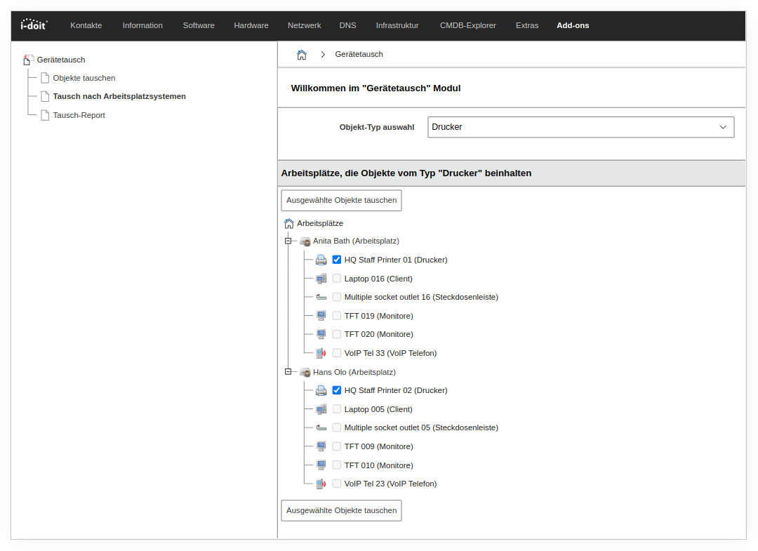

Swap by Workplace#
You can carry out a pre selection for swapping via assigned workplaces. First select an object type under Add-ons → Replacement → Swap by workplace. Then all objects of the type Workplace, in whose Workplace components category objects of this type are assigned, will be listed. You select an object for swapping from the respective workplace. With the button Swap selected objects you can reach Add-ons → Replacement → Swap objects.

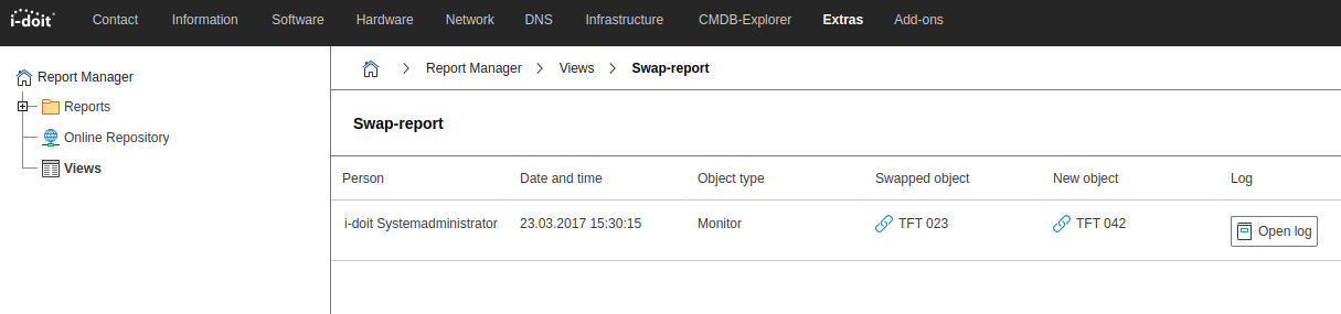

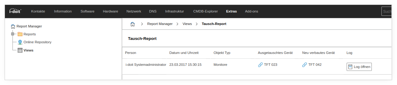

Swap Report#
A report about swapping actions which have been carried out so far is generated under Add-ons → Replacement → Swap-report. You can also reach the reports item via Extras → Report Manager → Views → Swap-report.
