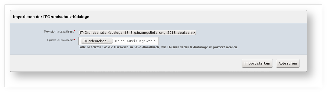

The catalogs are available for download on the BSI website. Depending on the supplement edition, some minor intermediate steps may be required to convert the catalogs into the correct file format.
Intermediate steps are necessary for the import because the format offered by the BSI cannot be processed directly by VIVA. The catalogs are available for download on the BSI website. The additional steps are:
  1. After downloading: extract the ZIP file
  2. Extract the self-extracting archive (.exe)
  3. Navigate to the GSHB folder; the subfolder DE is located there
  4. Rename the DE folder to el15de
  5. Compress the el15de folder in ZIP format

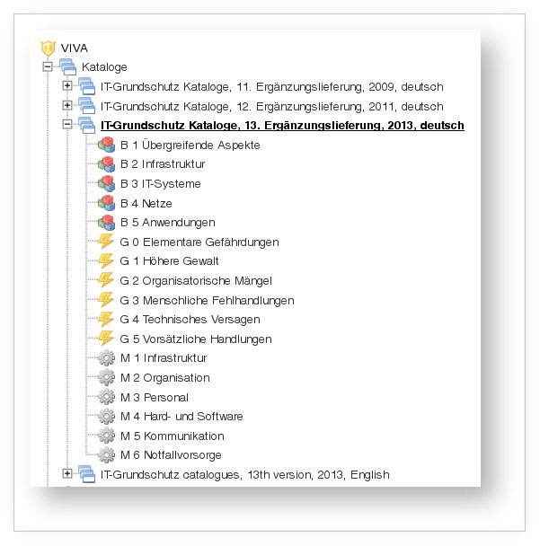

Import catalogs
The ZIP file can now be processed by VIVA. In the Catalogs menu item, click the Import button. A dialog box appears where you can select the desired supplement edition and the corresponding ZIP file. Confirm your selection by clicking Start Import. The import may take several minutes and should not be interrupted.
After a successful import, the supplement edition appears on the loaded page and can be used. If additional editions are needed, repeat the previous steps.
Imported catalogs in the menu tree

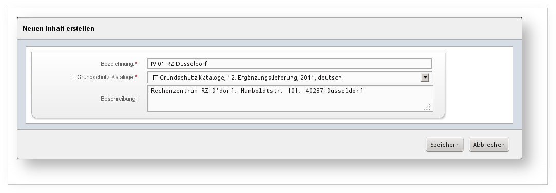

Modeling information domains#
Under the Information Domains menu item, one or more information domains can be created. They represent the starting point for more in-depth documentation. When creating an information domain, you must ensure that the correct IT-Grundschutz catalogs are applied to it.
Create information domain
When a new information domain is created, a target group with the same name and a matching target object is automatically created. The layer 1 modules Overarching Aspects are applied to this target group. Likewise, the protection needs categories are populated with the examples from BSI standard 100-2.

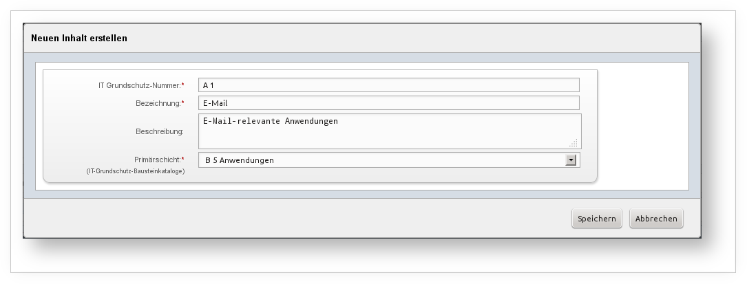

Creating target groups#
In target groups, similar target objects are grouped together. This process is part of the structural analysis (see BSI standard 100-2, chapter 4.2). Target groups appear in the menu tree below the five layers of an information domain. When creating a target group, it is first assigned to one of the following layers:
  1. Overarching aspects,
  2. Infrastructure,
  3. IT systems,
  4. Networks, and
  5. Applications.
Create target group

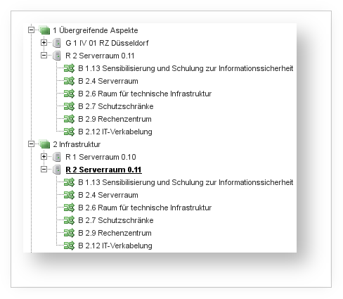

The layer membership can be extended by assigning modules from other layers. The information domain itself is assigned to layer 1, which happens automatically when a new information domain is created. An exception is the migration from the old module (migration): there, the layer assignment is determined based on the assigned modules.
Target group R 2 appears in 2 layers.

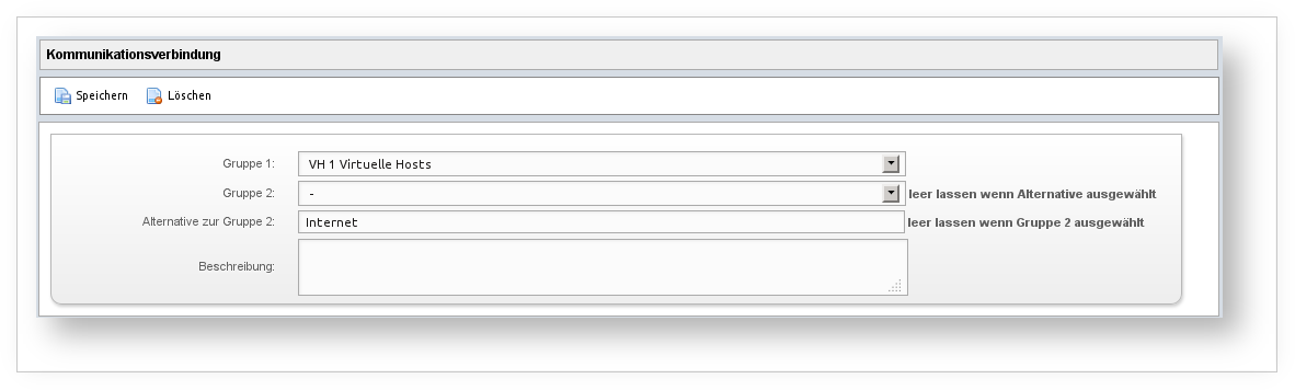

Target groups in layers 4 Networks and 5 Applications behave differently from those in the other layers: target groups in layer 4 do not contain target objects, but instead consist of a link between two target groups, which is documented under the Communication Link section. Instead of linking two target groups, you can alternatively link a group with something outside the information domain. Example: the target group is linked to the internet.
Edit target group in layer 4

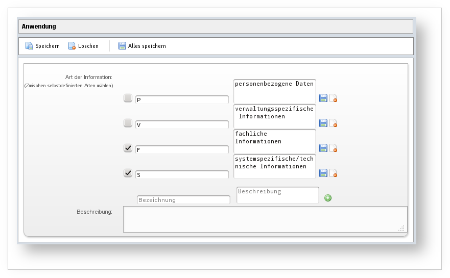

Target groups in layer 5 are extended with the type of information they process. VIVA already comes with several types that can (and should) be edited. It is important here to specify whether personal data is being processed, because this information is used repeatedly throughout the further process. This type therefore cannot be removed.
Edit target group in layer 5

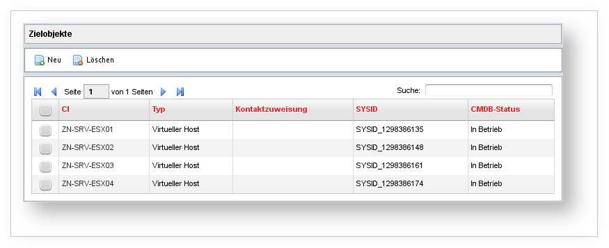

Assigning target objects#
Within target groups, target objects are determined. An exception is the target groups in layer 4 Networks. This is part of the structural analysis. VIVA is tightly integrated with the CMDB data from i-doit at this point. New target objects are selected using the object browser familiar from i-doit.
List target objects
The integration with CMDB data is reflected in additional places. Wherever it makes sense, contacts (persons, person groups, organizations) can be linked, for example.

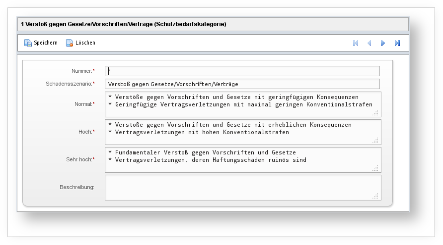

Defining protection needs categories#
Below an information domain, the Protection Needs Categories item appears in the menu tree. According to BSI standard 100-2, chapter 4.3.1, this is where damage scenarios are defined using protection needs categories. When an information domain is created, the examples mentioned in the standard are adopted and should be adapted to your own organization.
Edit protection needs category

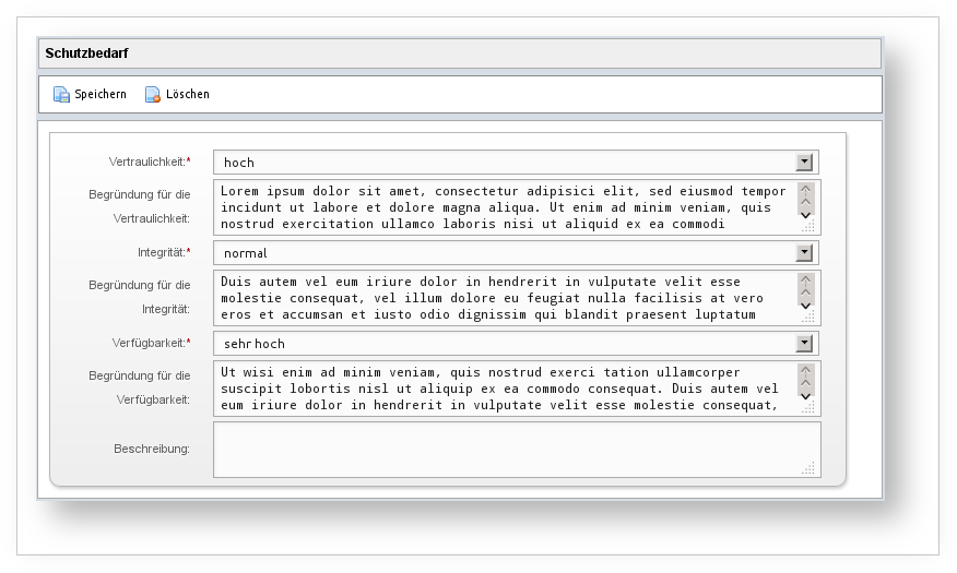

Determining protection needs#
As part of the protection needs assessment, the protection needs of the individual target groups are determined. (See BSI standard 100-2, chapters 4.3.2 to 4.3.5.) The corresponding form fields are located within each target group.

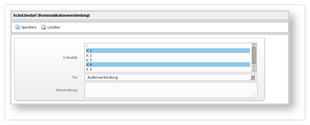

A special rule applies in layer 4 Networks: the protection needs of communication links are based on the assigned criticality.
Edit protection needs of a communication link

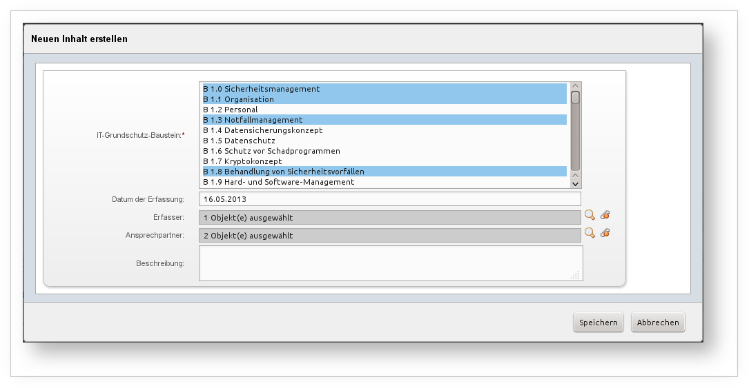

Assigning modules#
Modules from the IT-Grundschutz catalogs are assigned to the target groups. (See BSI standard 100-2, chapter 4.4.) Modules contain threats and measures including their qualification levels, which VIVA automatically stores when a module is assigned.
Assign modules to a target group
If modules from a layer other than the one assigned to the target group are selected, this causes the target group to also be assigned to that other layer. In the menu tree, this group then appears simultaneously under multiple layers.
When a new information domain is created, all modules from layer 1 Overarching Aspects are automatically assigned to the target group that is created along with it.

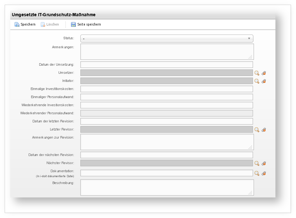

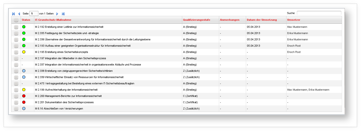

Implementing measures#
Measures are by definition designed to be implemented in order to counter identified threats. The qualification level that each linked measure receives allows for prioritization. (See BSI standard 100-2, chapters 4.4 and 4.5.)
List assigned measures
Clicking on a linked measure beneath a module assigned to a target group allows you to document the implementation status in detail.
Document implementation of a measure

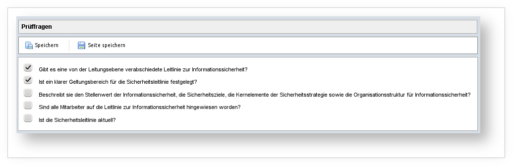

Answering audit questions#
Measures typically come with a series of audit questions that serve as a checklist to be checked off. All questions can be answered with either "yes" or "no".
The audit questions included in the catalogs are already taken into account during the import and are displayed within the measures. In addition, these can be edited, deleted, or supplemented with new ones.
Answer audit questions for a measure
The checklists composed of audit questions are available within measures assigned to target groups.

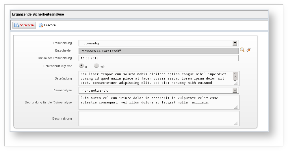

Performing supplementary security analysis#
The supplementary security analysis (see BSI standard 100-2, chapter 4.6) is performed for each target group. Whether this step is even necessary is determined automatically by VIVA based on the data from the protection needs assessment (of the communication links) and the specification of whether a supplementary security analysis is required beyond those specifications.
Edit supplementary security analysis
