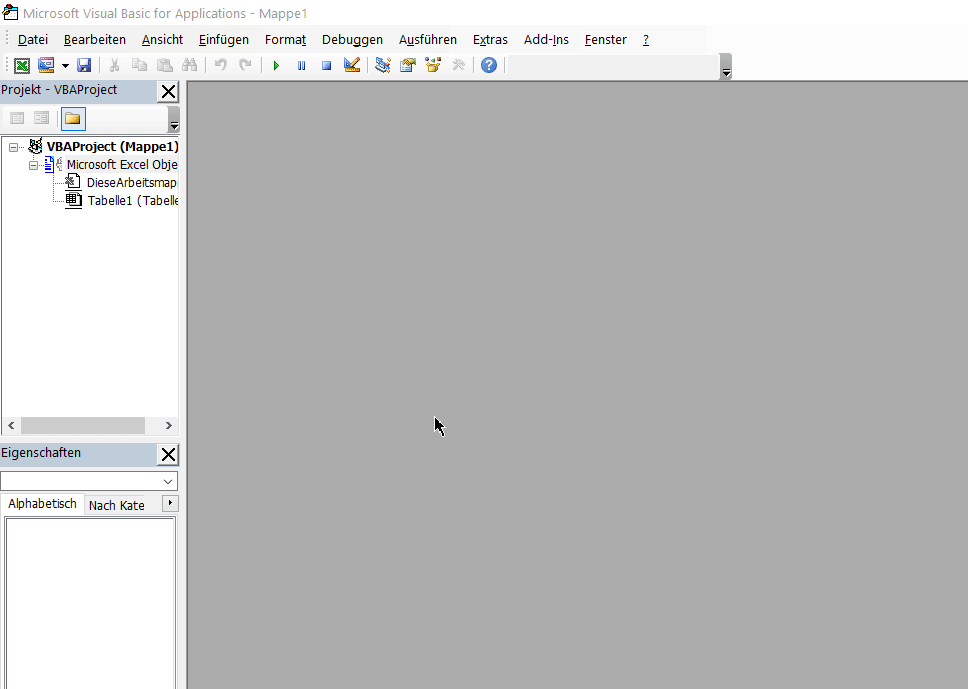

  3. Press Alt + F11 to open the VBA editor

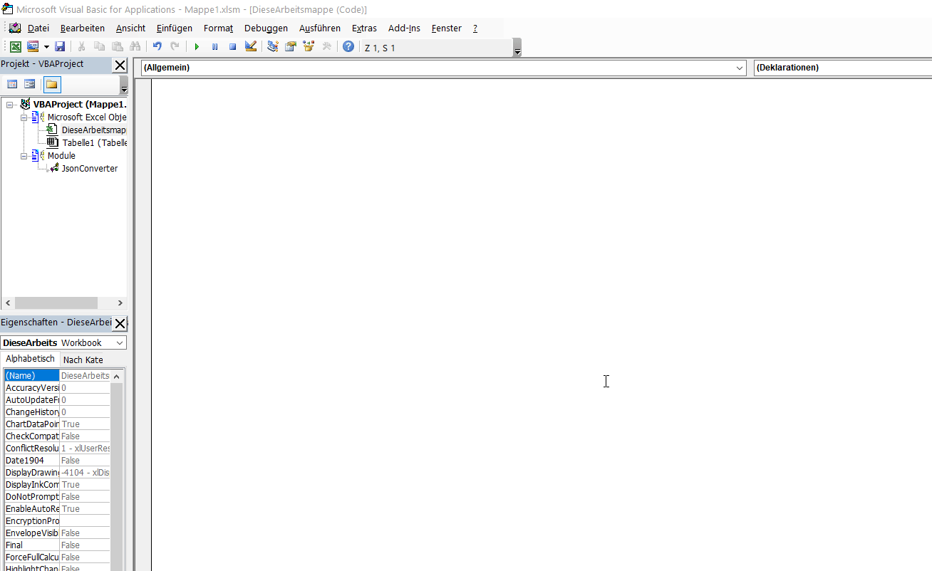

  4. Import the VBA-JSON code as shown in the GIF
    Import code
  5. Under Tools/References, enable Microsoft Scripting Runtime

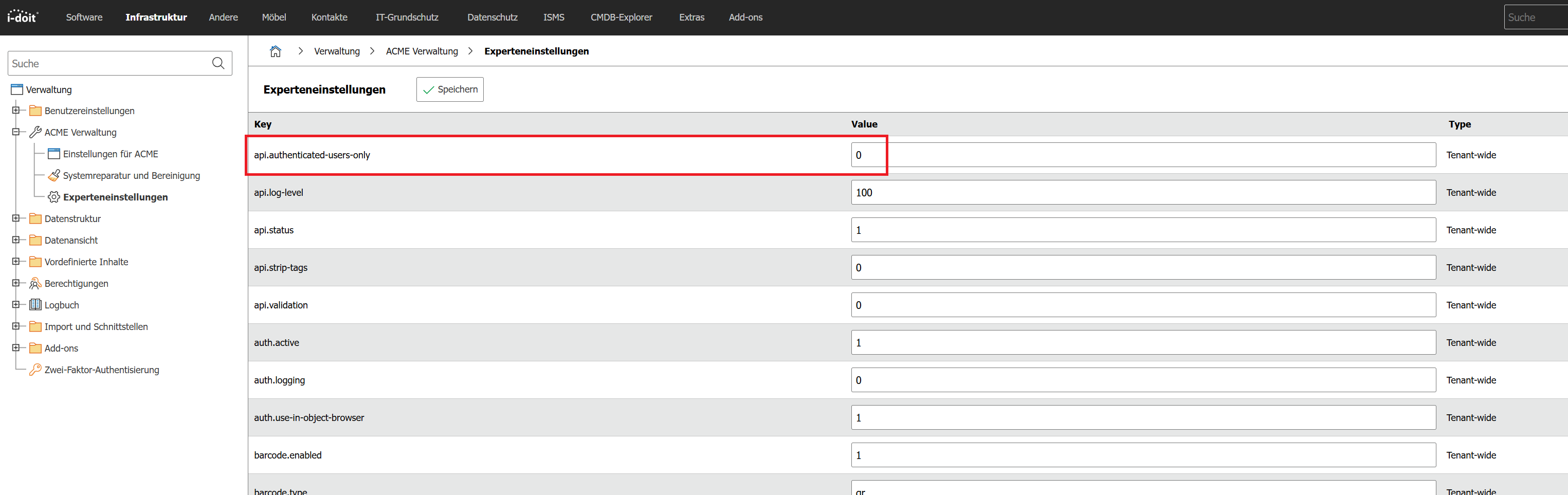

  6. In i-doit under settings in Expert Settings, the key api.authenticated-users-only must be set to 0
    Settings

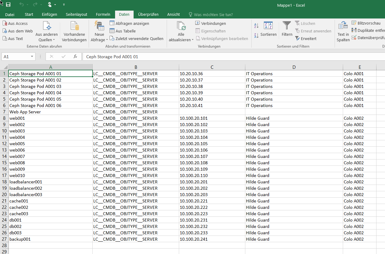

  8. Execute the code in the VBA editor by pressing F5. The result should look as follows: Excel

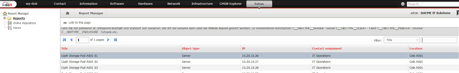

In the data, we find the column titles from the targeted report with ID 2.
Reports
