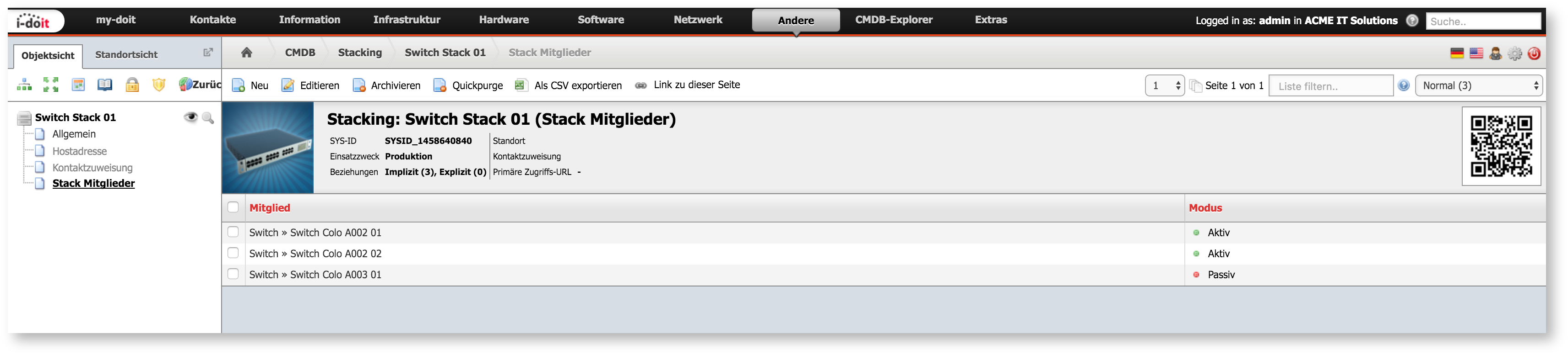

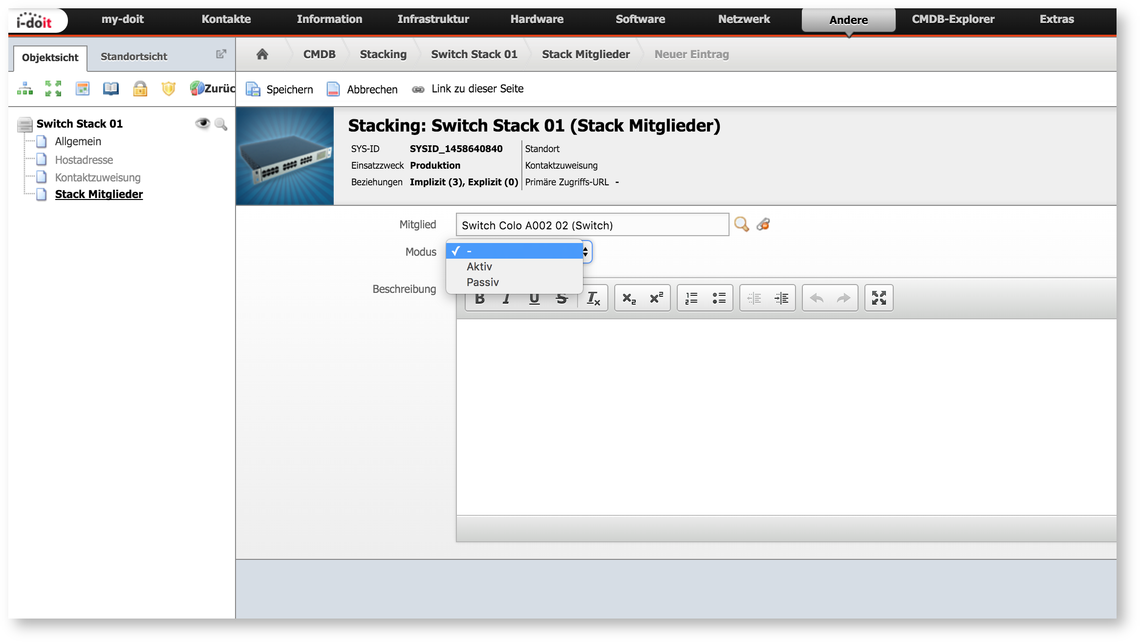

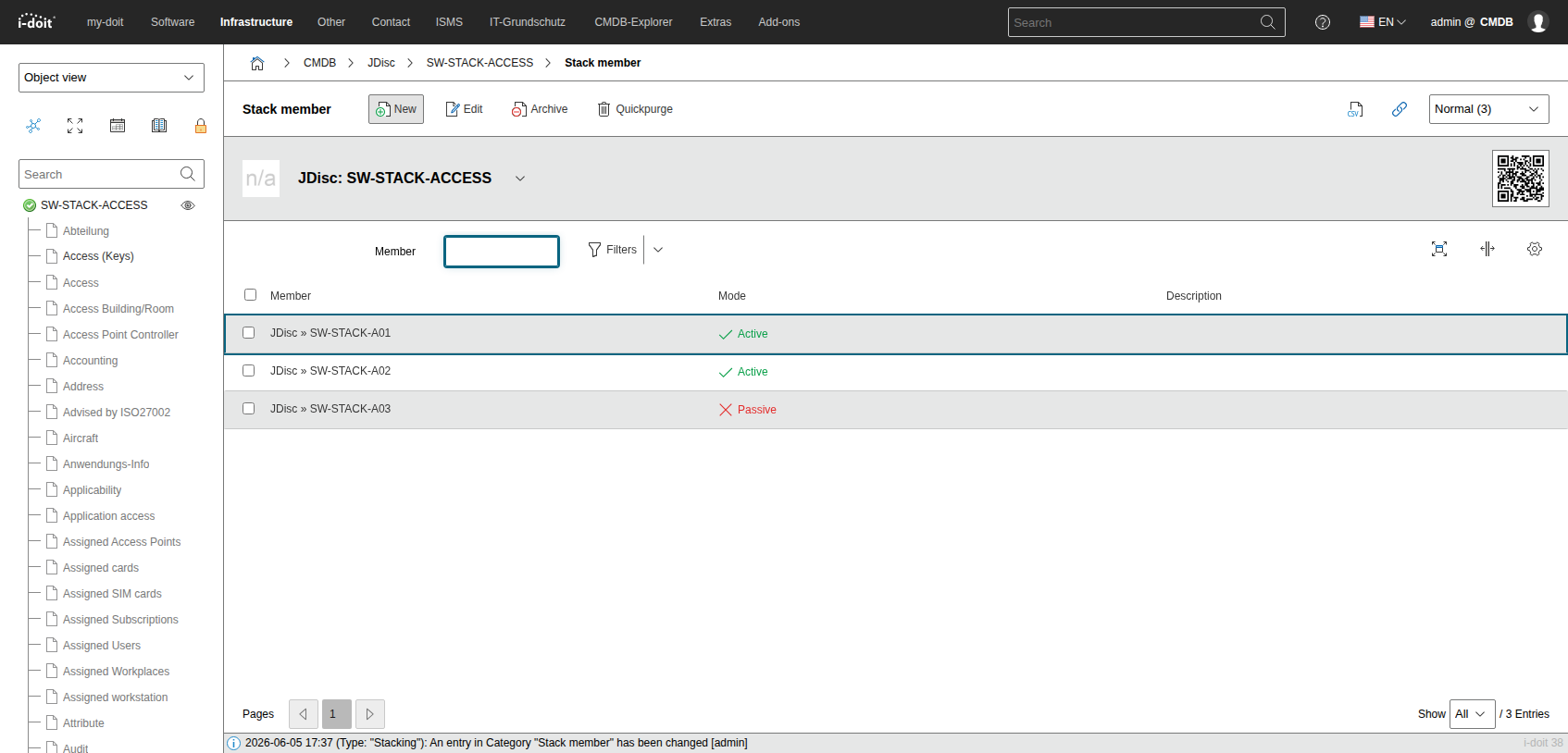

Stack Members#
In the Stack Members category created for stacking, objects can be added as members of the stack and marked as "Active" or "Passive". In the documentation, this marking has no further effect other than the corresponding display.
Stack members
Stack members

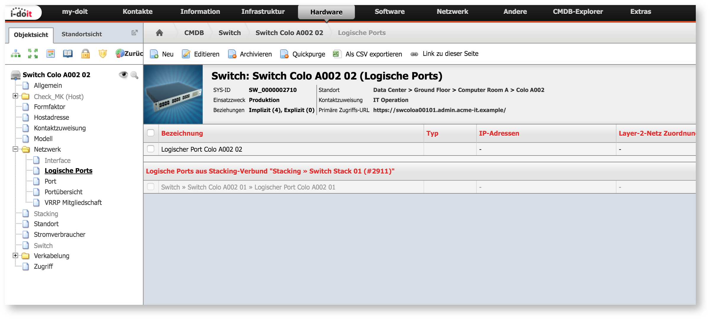

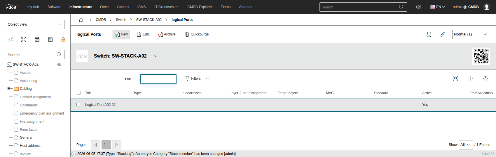

Logical Ports#
When a logical port is created in one of the stack members, it now also appears in the other stack members under logical ports.
Logical ports

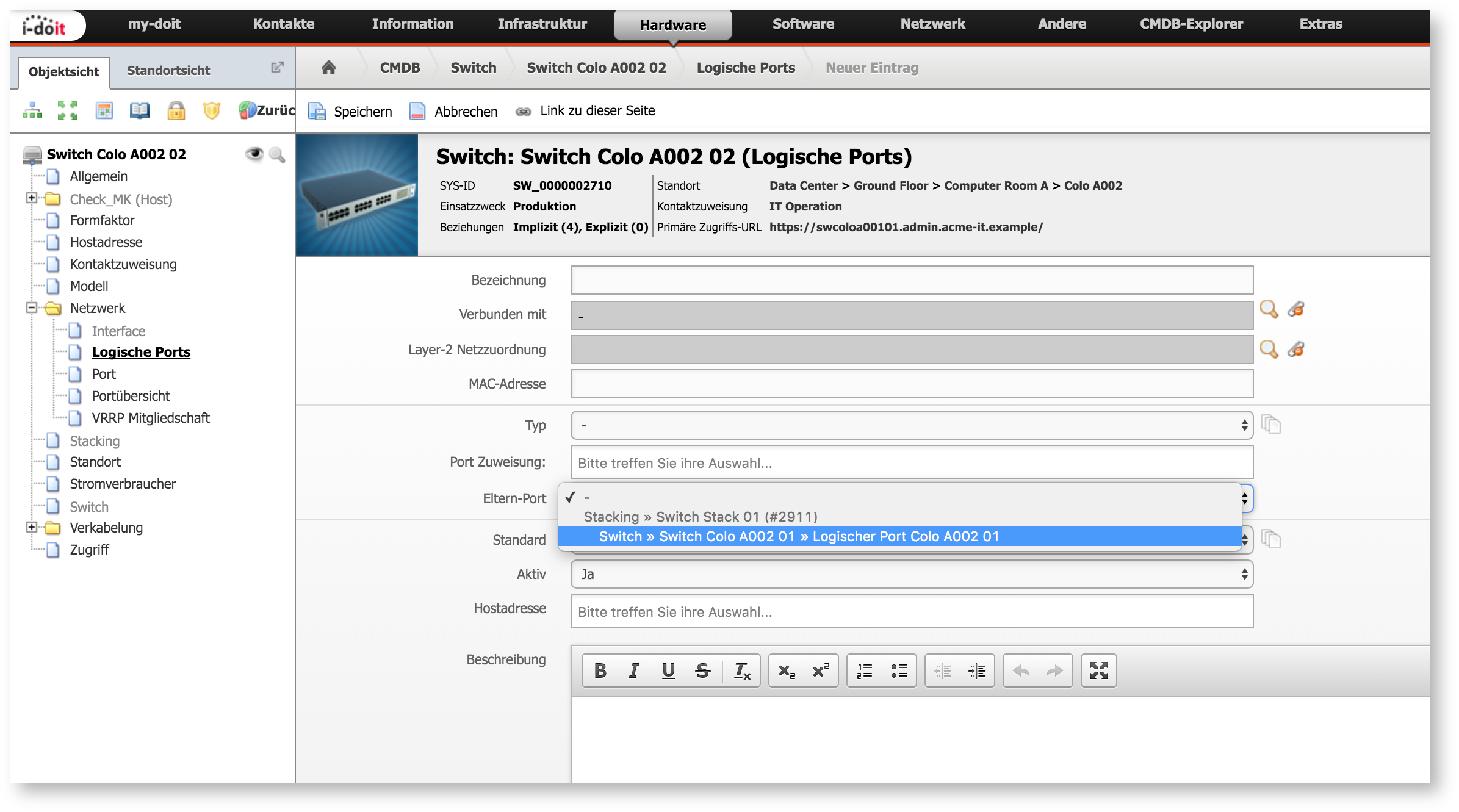

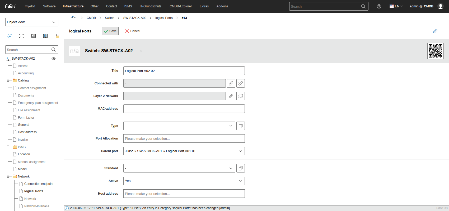

Additionally, the logical port of another stack member can be assigned as the parent port of a port.
Logical ports
