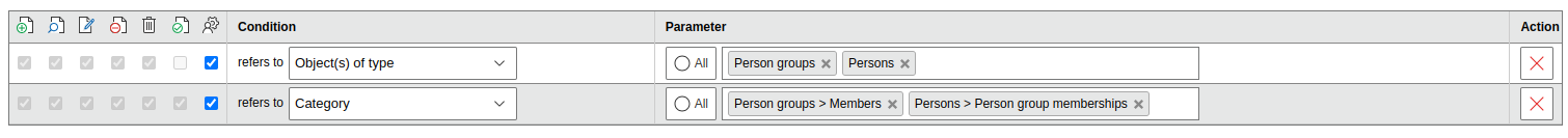

Required rights for the LDAP sync#
A user for the ldap-sync command requires the following minimum permissions:
1. Administration (command execute)
  • Condition Commands and All rights for the parameter SyncCommand.
2. CMDB (edit objects & groups)
  • Condition category in object type "Persons" and All rights for the category Persons - person group membership.

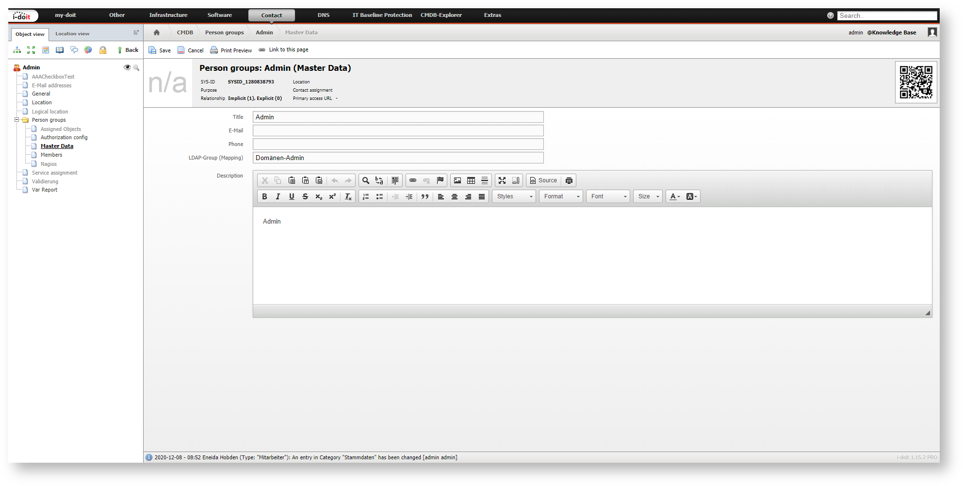

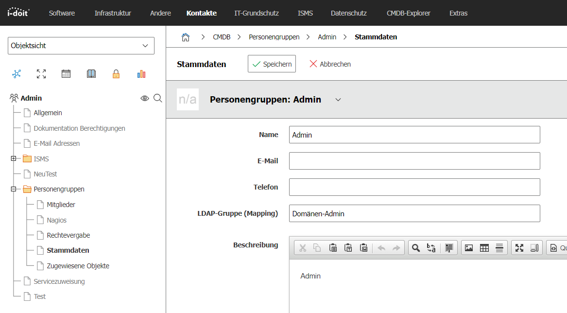

Automatic assignment of persons to person groups#
The automatic assignment ensures that users receive the permissions of their person group automatically after login.
To set up the assignment:
  1. Open a person group in i-doit and switch to the category Person groups inside the folder of the same name.
  2. Enter the name of the corresponding LDAP/AD group in the LDAP-Group (Mapping) attribute and save.
During login or synchronization, i-doit compares the user's group memberships in the directory with the configured mappings. If they match, the person group is automatically assigned.

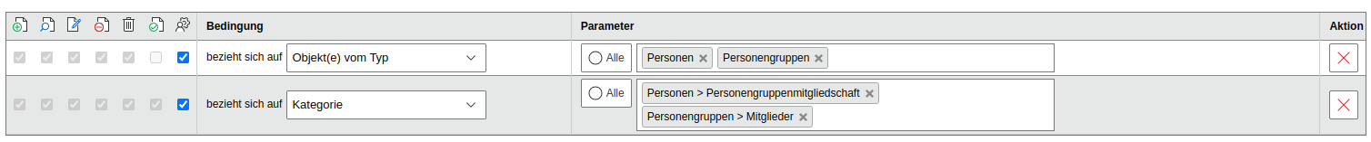

The executing user requires supervisor permissions on the categories Group membership and Person groups > Members as well as on the object types Persons and Person groups.
