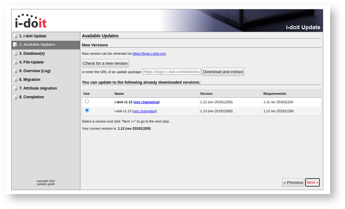

Updating 1.7.4 to 1.8#
First, we prepare the update via CLI by open the i-doit Folder at /var/www/html/ and unzip the idoit update package with
sudo -u www-data unzip idoit-1.8-update.zip
If you are asked, overwrite everything by typing A.
Now we open the Web Interface Updater and the Update to v1.8 is displayed and selected, do the update.
Possible error
PHP Fatal error: Call to undefined method idoit\Component\ContainerFacade::has() in /var/www/html/src/idoit/Model/Summary/SystemSummary.php on line 185 Solution is to reload the page and go on.
Check the update Logs
Please take the time to Scroll down the logs and check if a error occurred Login and check your installation.

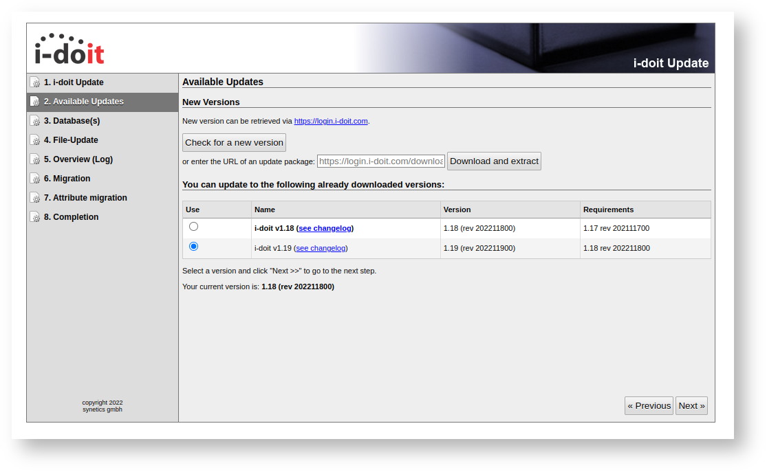

Updating 1.8 to 1.9#
sudo -u www-data unzip idoit-1.9-update.zip
If you are asked, overwrite everything by typing A. Now we open the Web Interface Updater and the Update to v1.9 is displayed and selected, do the update.
Updating 1.8 to 1.9
Updating 1.9 to 1.10#
sudo -u www-data unzip idoit-1.10-update.zip
If you are asked, overwrite everything by typing A. Now we open the Web Interface Updater and the Update to v1.10 is displayed and selected, do the update.
Updating 1.10 to 1.11#
sudo -u www-data unzip idoit-1.11-update.zip
If you are asked, overwrite everything by typing A. Now we open the Web Interface Updater and the Update to v1.11 is displayed and selected, do the update.

Updating 1.12 to 1.13#
sudo -u www-data unzip idoit-1.13-update.zip
Now we open the Web Interface Updater and the Update to v1.13 is displayed and selected, do the update.
Probably you will get this error:
Possible error
Fatal error: Uncaught Error: Class 'idoit\Module\License\LicenseServiceFactory' not found in /var/www/html/updates/versions/v1.13/migration/license_migration.php:50 Stack trace: #0 /var/www/html/updates/classes/isys_update_migration.class.php(98): include() #1 /var/www/html/updates/update.inc.php(911): isys_update_migration->migrate('/var/www/html/u...') #2 /var/www/html/src/hypergate.inc.php(152): include_once('/var/www/html/u...') #3 /var/www/html/index.php(231): include_once('/var/www/html/s...') #4 {main} thrown in /var/www/html/updates/versions/v1.13/migration/license_migration.php on line 50
Then you need to restart the update again.
If you now get a HTTP 500, do the update again.

Updating 1.18 to 1.19#
sudo -u www-data unzip idoit-1.19-update.zip
If you try the update without PHP 7.3 you will see this message:
Possible error
You have PHP 7.3.31. For updating i-doit to the next version you need at least PHP 7.4!
Now we open the Web Interface Updater and the Update to v1.19 is displayed and selected, do the update.
Check the System and i-doit

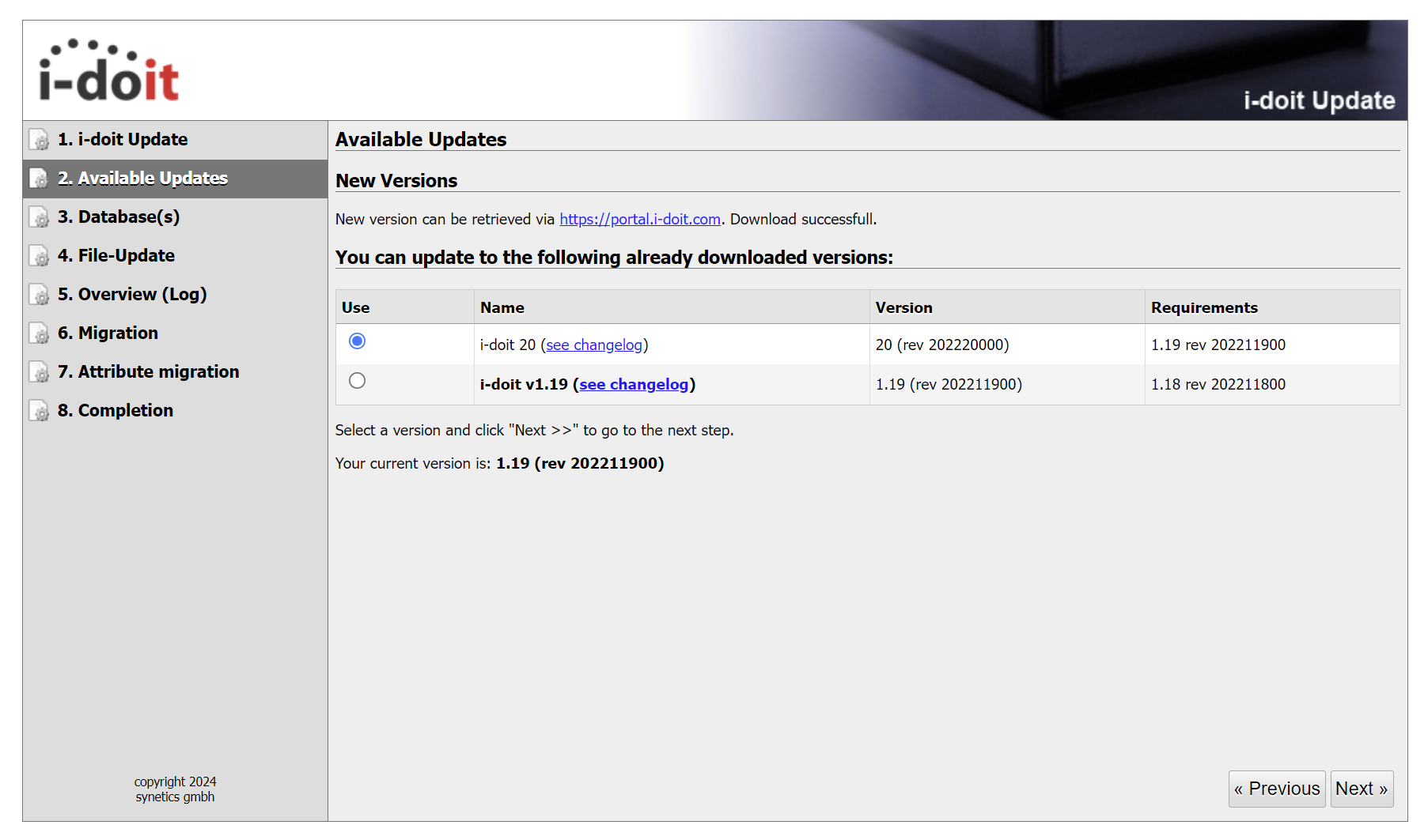

Updating 1.19 to 20#
First open the Web Interface Updater.
By clicking Check for a new version you can check whether a newer package is available. For this purpose, you require an internet connection.
If a new version is available the update package can be downloaded and extracted with a click on Download
If you're not connected to the internet, you can prepare the update via CLI by open the i-doit Folder at /var/www/html/ and unzip the idoit update package with
sudo -u www-data unzip idoit-20-update.zip
In the Web Interface check if the Update to Version 20 is displayed and selected, then do the update.
Updating 1.19 to 20

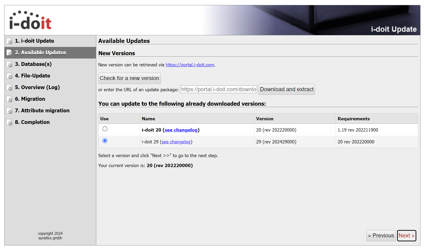

Updating 20 to 29#
First, you need to prepare the update via CLI by open the i-doit Folder at /var/www/html/ and unzip the idoit update package with
sudo -u www-data unzip idoit-29-update.zip
In the Web Interface Updater check if the Update to Version 29 is displayed and selected, then do the update.
Updating 20 to 29
